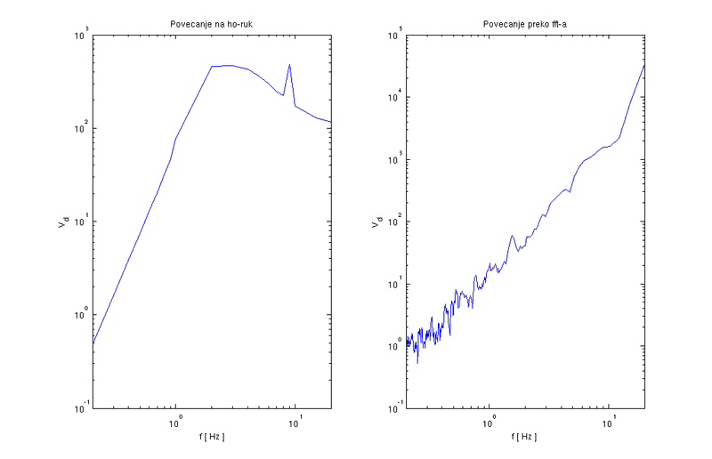

And to be direct my problem was determining the amplitude response for a horizontal seimograph.
In the picture on the left is the one obtained by forcing it with a current(via induction).While the right one is given by analyzing the spectral density of a pulse and then multiplying it with phase velocity squared to get the amplitude response.
My problem is the difference that gets bigger with higher frequencies.
Anyway,thanks for the effort,its much appreciated
