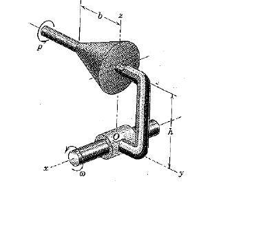

If an object is rotating about the axis of symmetry
and you are trying to find the angular momentum about the mass centre g.
Does a rotation about the axis of symmetry correspond to a rotation about the principle axis?
For this question i am trying to find the angular momentum about the mass centre of cone which is rotating about its axis of symmetry. However the axis of rotation is also rotating about the z axis.
Does the angular velocity w effect the angular momentum about the mass centre? I am guessing it would...
The only thing i am not sure about weather or not angular momentum about G would be evaluated about the principle axis
Every axis of symmetry is a principal axis.
The principal axes of a cone are its centre line, and every direction perpendicular to that line.
To find the angular momentum, you must first find the angular velocity …
if that is along a principal axis, then just multiply by the moment of inertia; if not, then use the tensor method. :wink:
