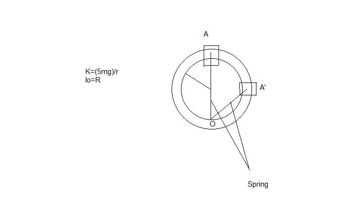

the spring oa is fixed from one end o to the bottom of a vertical circular smooth tube and from its other end to a slider a of mass m which can slide smoothly along the tube initially started from rest at a .
find :
i) angular velocity
II) angular acceleration at any angle
iii)angle at which the slider comes to instantaneous rest
Conservation of energy and netwen 2nd law
1/2 mv^2 + 1/2 Kx^2 + mgh=1/2 mv^2 + 1/2 Kx^2 + mgh
fn=fan = mrΘdot = n-mgcosΘ +kx
ft=f at = mrΘt double dot = -mgsinΘ
Θ(dot)^2 = 2mgcosΘ + 2gr
i think i made a mistake & hope someone can help with this situation
I'd like to see your working for your attempted solution. The fact that you have kx appearing in your expression for fn but not adding a component to ft suggests that you are viewing the spring's force as directed towards the circle's centre. It isn't.
