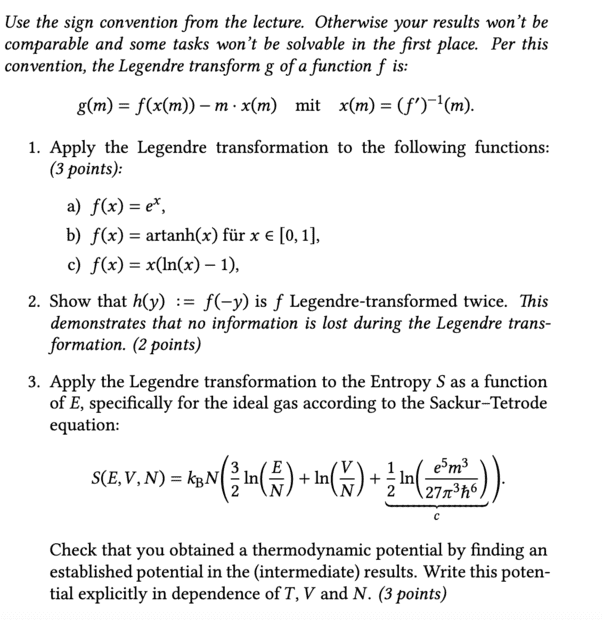

##g(m)=f(x(m))-m*x(m)## and ##x(m)=(f')^-1(m)##
Hi,
Unfortunately I am not getting anywhere with task three, I don't know exactly what to show
Shall I now show that from ##S(T,V,N)## using Legendre I then get ##S(E,V,N)## and thus obtain the Sackur-Tetrode equation?
You should rather think in terms of differentials. The "natural independent parameters" for ##S## are ##(E,V,N)##. Now you want to get another potential with the "natural independent parameters" ##(T,V,N)##. So first write down the differential ##\mathrm{d} S## in terms of ##(E,V,N)## and then think about, how to Legendre transform to a new potential with the other set of independent parameters.
Thanks vanhees71 for your help 👍
I have now represented ##ds## as follows
$$ds=\frac{\partial S}{\partial E}dE+\frac{\partial S}{\partial V}dV+\frac{\partial S}{\partial N}dN$$
$$ds=\frac{1}{T}dE+\frac{P}{T}dV-\frac{\mu }{T}dN$$
Now I would just have to get rid of the ##dE## or rather I would have to express ##dE## with the help of ##dT##, ##dV##, ##dN##, right?
Write it in the form of ##\mathrm{d} E=...## then find a new potential, ##F## ("free energy"), such that instead of a differnetial with ##\mathrm{d} s##, ##\mathrm{d} V## and ##\mathrm{d}N## you get one with ##\mathrm{d} T##, ##\mathrm{d}V## and ##\mathrm{d}V##. Note that
$$\mathrm{d}(Ts)=s \mathrm{d} T + T \mathrm{d} s!$$
Thanks for your help vanhees71 👍 I think I got it now 😀
