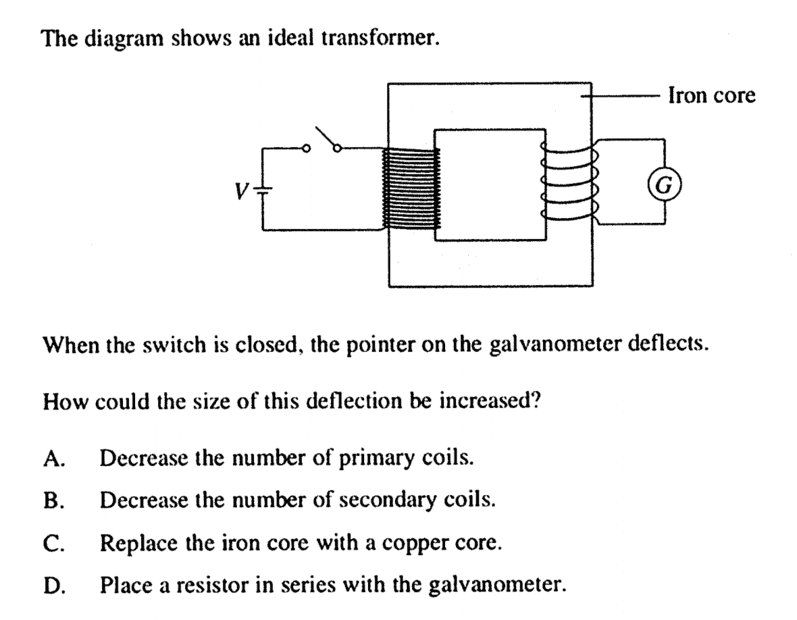

See below
n1/n2 = V1/V2
V1I1 = V2I2
Answer B would increase the n1/n2 ratio and increase the deflection. Making it correct.
But also, Answer A would increase the current through the primary coil, and hence the power. This would increase the power in the secondary coil hence I2, leading to lower voltage V2. Making it also correct.
My other question, do Galvanometers like described in this question, function as voltmeters or ammeters?
I think you may be right that both "a" and "b" are correct. The Faraday EMF in the secondary will clearly be less for case ## b ##, but with less turns, you have much less inductance in the secondary.
Looking at it from another perspective, there will be the tendency for the current in the secondary to balance the current in the primary in the form ## N_s I_s=N_p I_p ##. Basically, the secondary tries to offset the change in the magnetic field in the core that the primary causes. This ignores the zero load current ## I_{po} ## for the ac case, but this should also hold to a reasonably good approximation for this case. With fewer turns (in the secondary), more current needs to flow in the secondary for this offset to happen.
Meanwhile "a" is correct, because the flux in the core needs to be much higher for the same primary voltage when the primary has fewer turns.
I think you may be right that both "a" and "b" are correct. (Edit: Please read to posts 12 -16. The conclusion is that "b" is incorrect.) I'd be interested in hearing what others might say. @alan123hk Perhaps you would find this of interest.
Only answer A is correct (##n_1/n_2## decreases hence ##V_1/V_2## decreases hence ##V_2## increases for constant source voltage ##V_1##)
Answer B will lead to smaller ##V_2## (##n_1/n_2## increases hence ##V_1/V_2## increases hence ##V_2## is smaller for constant source voltage ##V_1##) hence the deflection decreases, not increases. Remember the problem asks for when the deflection increases.
And from what i know Galvanometers are very sensitive voltage meters.

The galvanometer measures the current and ideally has zero resistance. For the case at hand, the secondary is short-circuited.
yes that was what troubles me, that the secondary is short circuited if the galvanometer measure current.
For an ideal transformer, the internal resistance of the secondary side galvanometer cannot be equal to zero, otherwise the current will become infinite. Suppose we use a resistive load to represent the galvanometer on the secondary side. The higher the voltage on the secondary side, the higher the current should be, and the voltage on the secondary side should be determined by formula ## V2 = \frac {N2} {N1} V1 ## .

The magnetic flux in the core without any current in the secondary will be proportional to the product ##N_p I_p ##. There is a strong tendency in an ideal transformer for the secondary current to negate any magnetic field from the primary by having a current turns product ##N_s I_s=N_p I_p ##. This would result in a current in the secondary that would increase as the number of secondary turns decreases.
This result is contrary to intuition from the Faraday effect analysis, where the primary is creating the magnetic field, and with a sufficient resistance in the secondary circuit, one can ignore currents in the secondary in computing the magnetic field of the core.
It might take a rather detailed analysis to get a more definitive answer to this question of whether reducing the number of turns in the secondary could in fact increase the measured current with a short-circuited secondary.

It can't be zero, since it has to move something (i.e. do work). There must at least be some inductance. OTOH, you could make it from super conductors and have no resistance, but then you would also need no field losses, like radiation for example.
These "ideal" circuit element never really make sense if you think too hard about them. They only work as mathematical constructs with some physical laws ignored.
A "superconducting" meter movement would look electrically like an inductor in a very slow tank circuit (having the mechanical resonance freq of the meter) ? I never liked doing motors...
The component that will affect things the most is the inductance of the secondary. There will also be a finite ## Z ## associated with the load, which should be very minimal. See https://www.physicsforums.com/threa...ng-high-low-power.1001193/page-3#post-6478878
@Dale writes out the differential equations in post 22, with the ac steady state solution in post 43.
For the case at hand, perhaps a short voltage pulse should be considered. In any case, the inductance of the secondary ## L_s ## is proportional to ## N_s^2 ##, (and the inductance of the primary ## L_p ## is proportional to ## N_p^2 ##), and the load ## Z ## should be taken to be very small.

Yes, indeed @hutchphd . The fallacy of thinking ## N_s I_s=N_p I_p ## will hold for this case is starting to come to light. If this were the case, then there would be zero magnetic field in the core, and then also no voltage across the primary. The OP posed a very good question, but a more in-depth analysis is starting to show that decreasing the number of turns in the secondary will clearly result in a lower current in the shorted secondary.

a follow-on to post 16: The problem states that a specified voltage is applied to the primary, thereby defining the magnetization in the core, as well as the voltage in the secondary. The result is a current will flow in the secondary given by ##i_s(t)=\frac{N_s}{N_p} \frac{v_p(t)}{Z} ##. This current in the secondary will be offset by an additional current in the primary of ## i_p(t)=\frac{N_s}{N_p} i_s(t) ## to be added to the current ## i_{po}(t) ## that would flow in the primary with very large ## Z ##. Thereby, we still have our result that ## N_s i_s \approx N_p i_p ##. @Dale 's equations for ## i_p(t) ## do indeed agree with this.
Had the problem specified that a current pulse of a given size is delivered to the primary, then I believe "b" would be a correct result. Instead, it specified the voltage, and "b" is incorrect.

Because this is an ideal transformer, we can assume that the magnetization current is zero, so the following two equations always hold.
$$ \frac {V_2} {V_1} = \frac {N_2} {N_1} ~~~~~~~~~~~ N_1 I_1 = N_2 I_2 $$
If the primary is connected to a voltage source ##(V_1)##, ## I_1 ## will change as the load changes.
$$\text {because} ~~~~~~I_2 = \frac {V_2} {R} = \frac {N2} {N1} \frac {V_1} {R} ~~~,~~~ I_1 = \frac {N2} {N1} I_2 = {\left( \frac {N_2}{N_1} \right)}^2 \frac {V_1} {R} = \frac {V_1}
{ \left[ {\left(\frac {N_1} {N2}\right)}^2 R\right] } $$
If the primary is connected to a current source ##(I_1)##, ## V_1 ## will change as the load changes.
$$ \text {because} ~~~~~~~ I_2 = \frac {N1}{N2} I_1 ~~~~,~~~V_1 = \frac {N_1} {N_2} V_2 = \frac {N_1} {N_2} I_2 R = \left[ {\left( \frac {N_1}{N_2} \right)}^2 R \right] I_1$$

When you are faced with a circuit with complicated elements, it is transformers, transistors, etc. It is often productive to substitute models made of simpler elements, as I discussed in this post:
https://www.physicsforums.com/threa...-coupling-high-low-power.1001193/post-6478419
Then you are left to decipher what your instructor means by ideal. The most ideal is Lm → ∞, k → 1 (L1=L2=0). Next most realistic is to include Lm and k near 1 (L1 & L2 small compared to the other circuit impedances).
The ideal galvanometer is odd, as you see in our replies. It is a device that measures current and has some series impedance, so you can just identify that as Z, a generic unknown constant. You'll find that it doesn't effect the outcome as shown in previous posts.

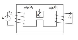

I think the question of this thread https://www.physicsforums.com/threa...gnetic-core-with-air-gap.914018/#post-5758745 is indeed tricky, especially when the value of load resistance ## (R) ##of ## i_2 ## loop is not zero (Short-circuited), it will be more difficult to find a general solution.
According to my calculation results, it has the following two strange characteristics.
1. ##~## when ## R ## is large, ##I_2## decreases as ##N_2## decreases, just like the case of a general transformer. However, when ## R ## decreases below a certain value, the situation is reversed ,that is, ##I_2## increases as ##N_2## decreases.
2. ##~## when ## R=0 ##, the magnetic flux of ##N_2## ## (\theta_2) ## become zero accordingly. However, a fixed ##I_2## flowing through ##N_2## still exist at this time , even though ## \theta_2 ## has become a zero value.
I have rarely encountered this kind of complicated but interesting problem.

@alan123hk Edit: Upon finding an error or two in my calculations, I now agree with both of your results.
(Here we are working the problem in the "link" of post 23).
For (1), the latest result I have is:
## i_2=\frac{E}{F+G} ##,
where
##E=N_1 i_1(\frac{l_3}{\mu_r} +d) ##
##F=N_2(\frac{l_1 +l_3}{\mu_r}+d) ##
##G=(\frac{jR}{N_2 \omega A})(\frac{1}{\mu_o})((\frac{l_2}{\mu_r})(\frac{l_1+l_3}{\mu_r}+d)+(\frac{l_1}{\mu_r})(\frac{l_3}{\mu_r}+d)) ##
I also agree with your result for (2) as ## R \rightarrow 0 ##, where ## B_2=\frac{j R}{N_2 \omega A } i_2##.
Note: To get results for a transformer without the middle leg, let ## d ## be large.

Assuming that the resistance of ##I_2## loop is zero, then ##N_2## is short-circuited, I tried to find the solution to this problem as show below.
First, since ##N_2## is a short circuit, the induced voltage of the ##N_2## is forced to zero. According to Faraday's law, the ## ~\theta_2 ~## is also zero, so it can be concluded that ## ~\theta_3 = \theta_1~ ##
Due to the very high permeability of the magnetic core, the magnetic field strength ##(H)## of the circuit ## ~ \theta_1~ ## will only be concentrated in the air gap ##(L_g) ##.
Now apply Faraday's law and Ampere's Law.
$$ N_1 I_1 = H L_g = \frac {B} {u} L_g = \frac {\theta_1} {u A} L_g = \frac {V} {j \omega \left( \frac {uAN_1} {Lg}\right)} ~~~~~~~~ \rightarrow ~~~~~~~~~~I_1 = \frac {V} {j \omega \left( \frac {{uAN_1}^2} {Lg} \right)}
$$ $$ N_2I_2 = H L_g = N_1I_1 ~~~~~~~~ \rightarrow ~~~~~~~~~~ I_2=\frac{N_1}{N_2}I_1= \frac {V} {j \omega \left( \frac {uAN_1N_2} {Lg} \right)}
Regarding the scenario of non-zero load resistance value of the ##~I_2~## loop, it will be more complicated to derive the complete description equations.

One item to note though is you use a very ideal ## \mu=+\infty ##. It can be worthwhile to use a finite ## \mu =\mu_r \mu_o ##, so that the results work even for the case of ## L_g=0 ##. (I used ## d ## for ## L_g ## in post 25). I also solved it for a finite ## R ## load resistor. It took some effort, but writing ## \oint H \cdot dl =\sum N_j i_j ## around 2 of the loops of the transformer, along with ## B_1=B_2+B_3 ##, made for a very algebraic solution. I also used ## v_2=i_2 R=-j \omega N_2 B_2 A ##, and ## B=\mu H ##.
Note: ## B_3 ## is assumed to be continuous across the gap.
For the most part, the solution is simply a lot of algebra.
The two loops are as follows:
## N_1 i_1-N_2 i_2=\frac{B_1}{\mu} l_1 +\frac{B_2}{\mu} l_2 ##
and
## N_1 i_1=\frac{B_1}{\mu} l_1 +\frac{B_3}{\mu} l_3+\frac{B_3}{\mu_o} d ##.
Next use ## B_3=B_1-B_2 ##, and also write ## B_2 ## in terms of ## i_2 ##. That leaves just two unknowns ## B_1 ## and ## i_2 ##, with two equations.

$$ N_1I_1+N_2I_2 = \chi_1~ \phi_1 + \chi_2~ \phi_2 ~~~~~~~,~~~~~~~N_1I_1 = \chi_1~ \phi_1 + \chi_3~ \phi_3
~~~~~~~,~~~~~~~\phi_3 =\phi_1-\phi_2 $$
After a long algebraic operation (details are omitted here), I get the following equations.
$$ \phi_1 = \frac {V_1} {N_1J\omega} ~~~~,~~~~ \phi_2 = \frac { \chi_3 \left(\frac {V_1} {N_1 } \right) }
{J\omega ( \chi_2- \chi_3) + \frac {(\omega N_2)^2} {R}
} ~~~~,~~~~ \phi_3 = \left[ \frac {1}{J\omega} - \frac { \chi_3 } {J\omega ( \chi_2- \chi_3) + \frac {(\omega N_2)^2} {R} } \right]\frac {V_1 } {N_1 }
$$ I_1 = \left[ \frac {\chi_1+\chi_3}{N_1J\omega} + \frac { \frac {(\chi_3)^2} {N_1} } {J\omega ( \chi_1- \chi_3) + \frac {(\omega N_2)^2} {R} } \right]\frac {V_1 } {N_1 }~~~~,~~~~
I_2= \frac { j\omega\chi_3 \left(\frac {N_2} {N_1 } \right) V_1} { J\omega ( \chi_2- \chi_3) {R}+ (\omega N_2)^2} $$
where ##~ R ~## is the load resistance of ##~I_2~##
I hope there are no errors in my derivation. In fact, it should not be said that this is a difficult thing, but just a very long and tedious algebraic operation.

In the first expression, it should be ## N_1 i_1 -N_2 i_2 ##
In the second expression, the reluctance needs to include the gap reluctance.
## \phi_2 ## is the easiest to compare with my post 25.
Writing out the complete solutions is too much work, but just writing out the one that I did in post 25 was useful. I checked the result for the limiting cases ## R \rightarrow 0 ##, and ## d \rightarrow ## large, etc., and that's how I located a couple of my algebra errors. I also needed ## i_2 ## to see how it does when ## N_2 ## is decreased. Your conclusions about ## i_2 ## in post 24 were correct, as verified by my expression in post 25.
additional note: I see you have an expression for ## i_1 ##. It appears you may have worked the problem for a specified ## v_1 ##, so that the results you get might differ from mine in post 25, where I used a specified ## i_1 ##.
Edit: Upon doing a conversion to compute ## i_1 ## in terms of ## v_1 ## , the results of @alan123hk started to look reasonably similar to mine,(I couldn't get them to completely agree), and it would prove very difficult to isolate any algebraic errors. (I did solve for ## B_1 ## in terms of ## i_1 ##. It is a simple expression relating ## B_1 ## to ## v_1 ##. That gave me the relation between ## v_1 ## and ## i_1 ##).

I found out where the error occurred in my derivation and corrected it. Now, I believe that my system of equations is completely free of errors.
According to the ratio of ##~i_2~## and ##i_1~## in my magnetic circuit equations, I can get exactly the same result as the following equations.
##E=N_1 i_1(\frac{l_3}{\mu_r} +d)##
##F=N_2(\frac{l_1 +l_3}{\mu_r}+d)##
##G=(\frac{jR}{N_2 \omega A})(\frac{1}{\mu_o})((\frac{l_2}{\mu_r})(\frac{l_1+l_3}{\mu_r}+d)+(\frac{l_1}{\mu_r})(\frac{l_3}{\mu_r}+d))##
As I believed before, there are multiple ways to solve the same problem, but the end result should be the same. :smile:
