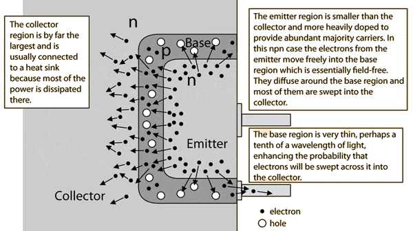

You can make BJT work in reverse direction, but the performance is very different. I am no expert in semi conductor physics, I did design BJT IC before. The collector is very lightly doped. p+ ion is then inject into the collector to form a base region inside the collector. Then the emitter is form by doping with n- ion inside the base region. Therefore the geometry is very distinct and non symmetrical. Also because the doping concentration is so different between the emitter and collector, the reverse breakdown voltage is very different. The reverse break down voltage of B-E diode is much lower, something like 3 to 6 volts only, so you really don't get much of the transistor even if you can live with the low β.
The geometry of the transistors regions along with the doping determines how it operates.
http://hyperphysics.phy-astr.gsu.edu/hbase/solids/trans2.html#c5
Yes, this is the cross section of an NPN I was trying to describe. They dope and form the collector tub first, then heavily doped the middle and form the base region. Then the last step is to heavily dope the middle of the base to form the emitter.
So if this is the case, then when current is applied to the base, the electrons from the emitter will pass through the base and to the collector and this allows the current from the power supply to pass through the collector? And if the base current is cutoff, do the electrons return to the emitter?

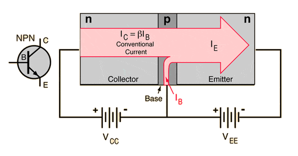

For a NPN transistor during normal operation, current from the supply enters the collector and exits the emitter as shown here:
By reversing the supplies (NOT normal operation), current enters the emitter and exits the collector. Of course you'll need a small base current for this to happen.
If there's no base current (cutoff) there will be no current in either case.
