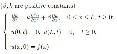

This is the first problem of the two.
Using separation of variables, I end up with
T'(t)= -λKT(t) and X''(x)+(β/K)X'(x)/X(x)= -λ. At first I chose the negative lambda because I saw that U(0,t) and U(L,t) needed to oscillate and I was hoping to get a sin function. Now the characteristic equation for X is something like r^2 + (β/K)r +λ=0 and I am not sure if I am on the right track in solving for the function X(x).

You're on the right path, but it helps to use 2 instead of λ.
thanks. I guess what I should have said is that I am stuck at this point.
Solve the characteristic equation for r. The solution has the form C1Exp(rx)+C2Exp(-rx).
This might become D1sin(r'x)+D2cos(r'x) depending on the sizes of β, k, and λ.
Edit:If r was imaginary, r' is a new constant that is real.
