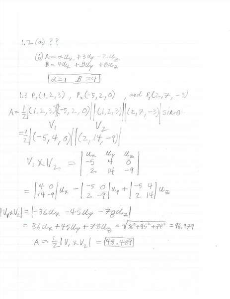

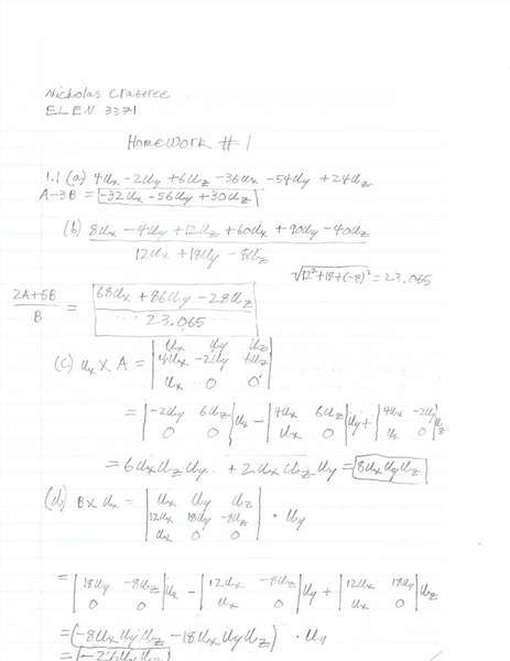

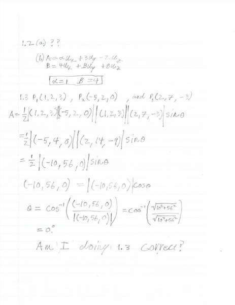

I actually need someone to check my work for 1.1 and 1.2. Is what I have done in 1.3 correct I mean it does not seem right?

For 1.1 (b) it looks like they want you to take the magnitude of B in the denominator... otherwise the expression wouldn't make sense.
For 1.1 (c), note that the items ux, uy, and uz are the unit vectors of the vector space. So when you take the cross product, don't introduce i, j, or k. The top row of your determinant should be |ux uy uz|. The same applies to 1.1 (d)

For 1.3, form two vectors that define the sides of the triangle and carry out the cross product. Then ##A = \frac{1}{2}|V_1 \times V_2|##.
Ok so the denominator for (b) should be 23.065. For (c) 8UxUyUz. For (d) -26UxUz. on 1.2 that is precisley what had me lost. I know that if they are parallel, then one vector must be a multiple of another. If perpendicular the dot product must result in a 0 and with alpha and beta only being tied to two terms. I struggle with how I can make this happen on the Z value for the parallel part. For part 1.3 A=48.489
Sure. So what then are the components of the resulting vector?
For (c) 8UxUyUz.
I don't understand that. The result of a cross product should be a vector.
For (d) -26UxUz.
Part d contains a cross product followed by a dot product. The result should be a single scalar value.

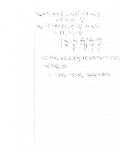

Show your work; that's not the value I'm seeing.
EDIT: Sorry, I didn't see your attachments. Looking at your work for 1.3, I see that you've done something bizarre to find the vectors defining the triangle: you're multiplying the point components! A vector from point A to point B is given by VAB = B - A.
For your cross products, the Ux, Uy, Uz stuff should ONLY appear in the top line of the determinant! Ux, Uy, and Uz designate the unit vectors of the vector space (or coordinate system axes). A vector written as: 3Ux + 5Uy -6Uz has Ux component 3, Uy component 5, and Uz component -6. It might also be written as: (3, 5, -6), with the understanding that those are the Ux, Uy, Uz components.

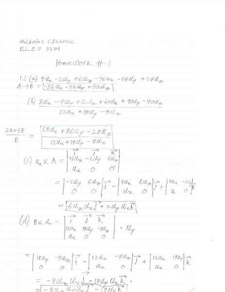

For (b) I get 2.948Ux+3.728Uy-1.213Uz. Did I do the cross product incorrect or something I am not understanding on part (c). Once again on part (d) I did the cross product and then used the dot product I am confused on what to do now?
Your part (b) result looks fine.
For the cross products, take a look at the EDITs I added to post #5.

ok for c I get 6Uy+2Uz and for d I get -8
Ok after doing as you suggested if I did it right alpha=-1 and beta=-12 also x=-4
yah thanks the refresh worked
Check the signs on your expansion of the cross product for c. -8 for part d looks fine.

ok my signs were off on (c) 6uy-2Uz
I still see a sign problem with the first term...!
doh! so you are saying it is -6Uy-2Uz. Are you sure, I have checked it 3 times and feel confident in my initial answer?
The order of the cross product matters! A x B = - B x A. Your attachment shows that you're computing A x Ux...
Ok good point it should be after reworking it again -6Uy-2Uz
to find magnitude (sqrt((-3)^2+(-30)^2+(-36)^2+(15)^2))/2 = 24.647
That is for the area of the triangle
Ummm, why do you have two separate Uy terms? Your vector should have exactly three independent components.
Forgot to collect them up sorry now I get 25.719

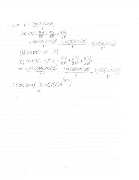

Calculate Gradient and Divergence
On 1.4 I think I am right but not sure? On 1.5 (a), (b), and (c) I am not sure if I did the partial derivatives correctly? On 1.6 Not sure if I computed the gradient right? On 1.7 not sure if i calculated the divergence right? On 1.8 I don't know what to do at all and need a bit of a push? I uploaded my work and the problem was in the first upload.
