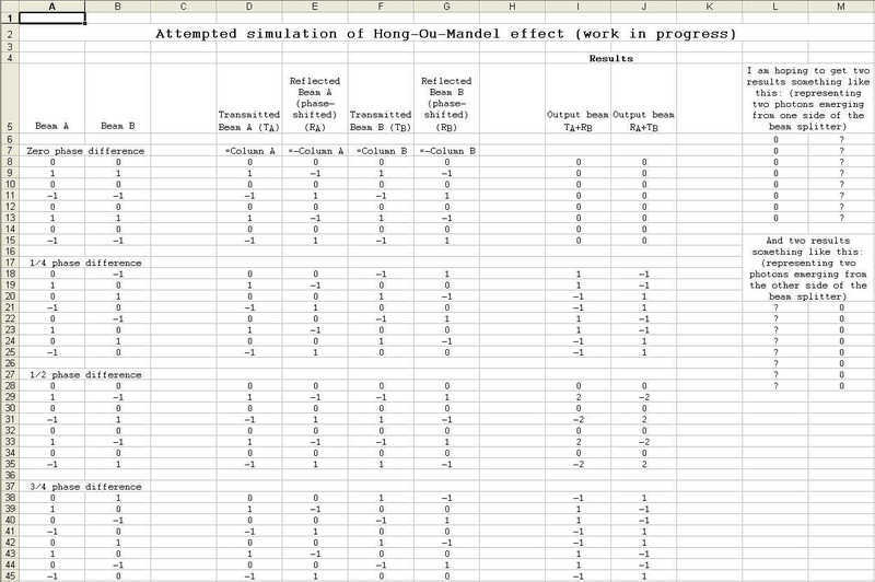

Hi Cthugha
In my previous thread which has now been closed, you mentioned the Hong-Ou-Mandel effect. I have attempted to simulate it in an Excel spreadsheet but I have not managed to obtain the correct-looking results. I have attached a Jpeg of the spreadsheet and would be very grateful if you could have a look at it. I am hoping that you will firstly understand what I am trying to do in the spreadsheet and then let me know what I am doing wrong. I may be basing the spreadsheet on completely wrong assumptions or interpretations of the Hong-Ou-Mandel effect.
Thank you very much.
Might help if you set the sheet to "show formula" in order to check them.
Use Ctrl + ` (Control grave, grave is the accent character to the left of the 1 key) to apply to the whole sheet.
If you do this, you may need to adjust the column widths, some of them may increase.
Hi Bahamagreen
Thank you for your reply.
There are no complicated formulas. It is just as follows:
Column A: absolute values
Column B: absolute values
Column D = Column A
Column E = -Column A
Column F = Column B
Column G = -Column B
Column I = Column D + Column G
Column J = Column E + Column F
