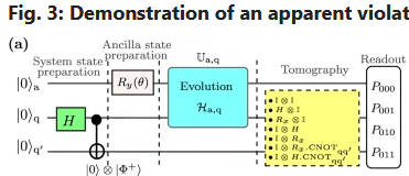

If you look at figure 3, you can see where the "magic" is. They're discarding runs where the ancilla qubit is true, and analyzing the leftover data as if they weren't doing that. The result is postselected dynamics that aren't unitary.
Note that e.g. P_111 is not present in the readout column:
Quantum circuit diagram titled Demonstration of an apparent violation: ancilla qubit a prepared by R_y(theta), qubits q and q' prepared as |0> with a Hadamard and CNOT making a Bell state |Phi+>, a Evolution block U_{a,q} acting on a and q, tomography boxes, and readout outcomes P_000, P_001, P_010, P_011.
> Do the findings of this experiment enable superluminal communication [...]?
No. When you actually run the experiment there is a "keep or discard" signal that has to eventually propagate to all qubits (or to all measurement results from those qubits).
> Do the no-go theorems of quantum mechanics apply in the NHQM systems studied in the subject experiment?
If you're talking about the postselected dynamics implied by interpreting the kept data as if it was all the data, then some apply and some don't. For example, no-cloning will still hold but no-signalling won't. That being said, I want to re-emphasize that the theorems still hold when you consider all of the data and that you need to be very careful not to confuse yourself by mixing up the post-selected dynamics with the non-post-selected dynamics.
