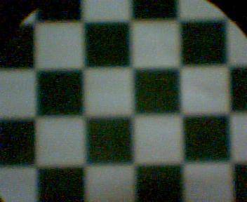

For a control systems project this semester, my friends and I are working on a closed feedback image focusing system. Using a webcam, an image of a black and white checkerboard is acquired by a computer program. Then, the amount of defocus (blur) in the image is measured and quantified in terms of a scalar, which is sent (via a parallel port interface) to a stepper motor controller which actuates a stepper motor that rotates the focusing knob of the webcam thus changing the focal length until the image captured is properly focused.
So far, we have made the parallel port interface, the stepper motor controller and a fairly decent mounting arrangement. We have also theoretically analyzed the images captured by the camera. However, we are not able to get a very good estimator of the blur or defocus in the image.
The first approach we used was to convert all the images to grayscale and use a Sobel Edge detection filter on them. Then, we generate a scalar [itex]x_{i}[/itex] for each image [itex]i = 1,\ldots,n[/itex], given by
[tex]x_{i} = \sum_{j = 1}^{j_{max}}|E_{ij}|^2[/tex]
where [itex]E_{ij}[/itex] is the vector of edges of image [itex]i[/itex] returned by the edge detector (in MATLAB).
We assume that the scalar is a good estimator of the sharpness of the image. If the scalar has a large value, then possibly the blur is low and vice versa.
This approach worked for a bunch of images, and we were able to plot the values to confirm that the scalar attained its maximum for the best focused image. But for another bunch of images, the scalar peaked at an image that was clearly not the best focused image.
The other approach we thought of was to inject Gaussian Blur into the images and then do a correlation analysis of the images to determine what values of mean and variance for the Gaussian estimate the "actual" blur nicely. Then we would generate a scalar based on these parameters to actuate the motor suitably.
While our hardware work is mostly completed, we're struggling to come up with a simple solution to the algorithm. Any suggestions and advice would be greatly appreciated! We have less than a week for our presentation :-(
Thanks in advance!

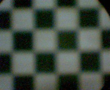

Here are two images of the checkerboard. Picture 41 is better focused than 31. This is the kind of output I want the system to generate. Doesn't have to be the best, but an improvement would be nice.
what are the main differences between both figures? Did you change the distance from your camera to the object?
I'm curious what you think of the link edmondng supplied.
Basically, it's a more advanced explanation of the topic I mentioned.
The distance between the object and the camera was not changed. Only the focusing knob was adjusted.

Yes, I am going through it. This image sums up what want to be able to achieve, using the software program: http://www.edmundoptics.com/imagelib/techsup/ResCont1final.gif .
So here's what I've done so far...
The system acquires about 900-1000 images of the checkerboard, at different focal length settings. The histogram of a focused checkerboard should have two peaks corresponding to black and white and no peaks any other color. (ideal_checkerboard.jpg)
A plot of the histogram of smoothly interpolated by a curve is generated, for each image. The area under this curve should (intuitively) be an estimator of the degree of defocus. We generate the area for each such curve and plot the area versus the image number. The value of i at which area(image i) is minimum corresponds to the most focused image.
But I am not sure if this is a good estimator.
Any other suggestions/ideas are welcome.
