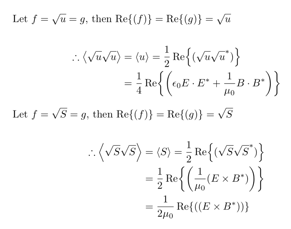

I don't really understand how to do this. I show my attempt below, but I don't think it is good. Can someone explain if it is really all there is to it?
My attempt: To calculate the average energy density, we use the formulaU = 1/2 * ɛ₀* E² + 1/2 * μ₀ * B². Where E and B are the electric and magnetic fields, respectively. Substituting the fields for this problem gives usU = 1/2 * ɛ₀ * (E₁ + E₂)² + 1/2 * μ₀ * (B₁ + B₂)².To calculate the Poynting vector, we use the formulaS = ɛ₀*E×BSubstituting the fields for this problem gives usS = ɛ₀ * (E₁ + E₂) × (B₁ + B₂).
