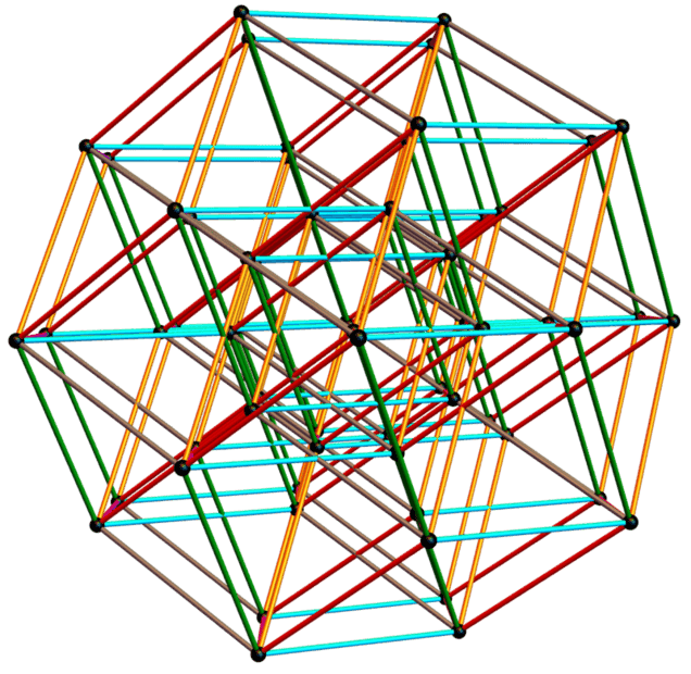

I'm looking to 3D print a ball-and-stick model (think organic chemistry kit) of a quasicrystal, and I'm looking for some guidance.
I'm imagining something like this:
The image was taken from the following paper, and is described as a rhombicuboctahedral quasicrystal. The paper itself gets very technical (at least for me), describing projecting a 4D crystal into 3D space. It seems to me based off of a rhombicuboctahedron, although I don't know if it's correct to naively use the angles from that shape when creating a ball and stick model.
I'm not fixed on this particular type of quasicrystal; any aperiodic 3D structure would do. (The more aperiodic, or more specifically the fewer continuous open channels, the batter).
My main question is, for whatever quasicrystal I choose: how do I determine what the orientation of the balls in the holes should be?
I'm also curious how easy it would be to assemble. If my memory serves me well, when using Penrose tiles, it would always be possible to fit another piece in when tessellating with them -- you would (at least in general) never get stuck. Would something similar occur for a ball-and-stick quasicrystal?
There is a video of someone designing and printing a quasicrystal assembly, so I have some confidence this is doable, but this is very new to me, so any guidance would be very helpful.
Thanks!

I found this wiki article on it with a stick diagram of an icosahedral crystal diagram that may be what you are looking for.
https://en.wikipedia.org/wiki/Quasicrystal
This is the image:
I'm still not sure how to figure out the orientation the holes in the balls would have to be though.

Wait, I thought you wanted to 3-D print this, but are you saying you are just going to 3-D print the sticks and the balls with holes in them to connect the balls with the sticks as you assemble this? I guess I misunderstood your original question...
Sorry for the confusion. Yes, I want to just 3D print the balls and sticks, allowing a person to assemble it.
Well, you will need the 3-D positions of each of the balls in the figure you want to make. If you have that data and know which balls need to connect to each other, the math isn't too bad to figure out the 3-D angles. The harder part is finding the 3-D position data for the figure you want to build. Can you find such data in the references of the Wikipedia article for one of the figures you want to build?

Check the file format, maybe that file gives the connecting sticks as lines.
Line from x1, y1, z1 to x2, y2, z2; gives the ends of every line in 3D.
Look for duplicate x, y, z values to identify the position of atoms.
