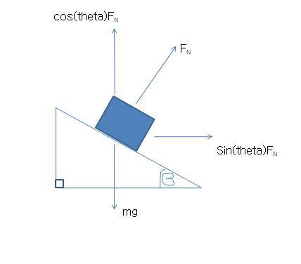

Q: "If a curve with a radius of 85m is properly banked for a car traveling 65km/h, what must be the coefficient of static friction for a car not to skid when traveling at 95km/h?"

2. The attempt at a solution
I found theta
FNcos(theta) = mg
(mgsin(theta))/cos(theta) = (mv2)/r
theta = 21.4o
But next bit i couldn't do.
Wouldnt the centripetal force of the 95km/h car be FNsin(theta) + musFN? as the static friction + the horizontal component of the normal force allows circular motion?
thanks
  • Free-body diagram of a block on a banked incline, showing the normal force FN resolved into cos(theta)FN vertically and sin(theta)FN horizontally, weight mg acting downward, and angle theta at the base.
milky9311 said:
FNcos(theta) = mg
FNcos(theta) = mg??:confused: Check that again...
