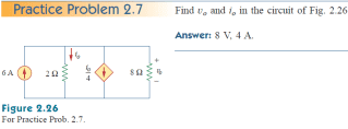

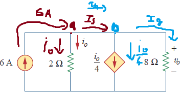

JasonHathaway Messages 113 Reaction score 0 Thread starter May 4, 2014 #1 Homework Statement Homework Equations KCL The Attempt at a Solution At node a: 6= io + Is At node b: Is= io/4 + I8 Couldn't go much further. Last edited: May 4, 2014

donpacino Science Advisor Gold Member Messages 1,439 Reaction score 285 May 4, 2014 #2 two things to note: 1.)a and b can be considered the same node as their voltage is the same. 2.)Also for calculating values such as I8 and Io, remember ohms law. V=IR try to use that relationship to finish your equation.

JasonHathaway Messages 113 Reaction score 0 May 4, 2014 #3 Vo=I8*8, Vo=Io*2 --> Vo=Vo, I8*8=Io*2 --> I8=Io/4?
berkeman Admin Messages 69,844 Reaction score 25,784 May 4, 2014 #4 JasonHathaway said: Vo=I8*8, Vo=Io*2 --> Vo=Vo, I8*8=Io*2 --> I8=Io/4? So now you can solve for Io and Vo...
