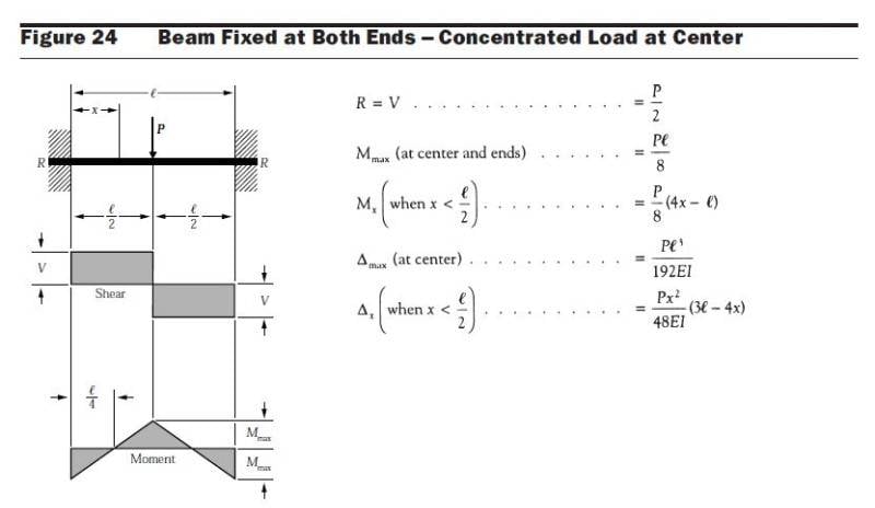

How is moment of P*length/8 exactly derived above? why divided by 8 and not 6 or others?
Does it depend on the gravitational constant or any Spacetime feature?
What kind of spacetime where there is no moment even if there is a loading?
To compute the moment at some point, we only consider those loads between one end (the left, say) and the point.
Since P is uniformly spread along l, only P/2 is applied to the left of the midpoint.
We could find its moment about the midpoint by an integral, but it is easier than that. We can just look at the average point of application. This is halfway between the left end and the midpoint of the beam, so at l/4 from the midpoint.
The moment is therefore (P/2)(l/4)=Pl/8.

But I think it is not a distributed load, it is point load.
Beams with fixed supporsts at both the ends are called statically indeterminate beams.Because, you can't directly find the reaction forces and reaction moments at the supports.In this case you may easily find the reaction forces(R=P/2) because the load acts exactly at the midpoint.
Iam not sure about how to find the reaction moments.Refer some books.
But to get moment.. why do you need to multiply the load by the length.. it's as if moment is load in circle or with circular radius?
Sorry- didn't read the diagram title.
As you say, it is not, strictly speaking, determinable, so they are assuming symmetry.
If the reaction force at the left is V and the moment is M then the moment at offset x is Mx=M-Vx=-ky" for some constant k.
(I take anticlockwise as positive.)
Integrating: ky'=Mx-½Vx2+c.
By fixture this is 0 at x=0 and by symmetry 0 at x=l/2:
c=0, M=Vl/4.
So Mx=V(l/4-x)=P/8(l-4x)
Looks like the book takes clockwise as positive.

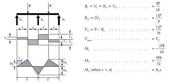

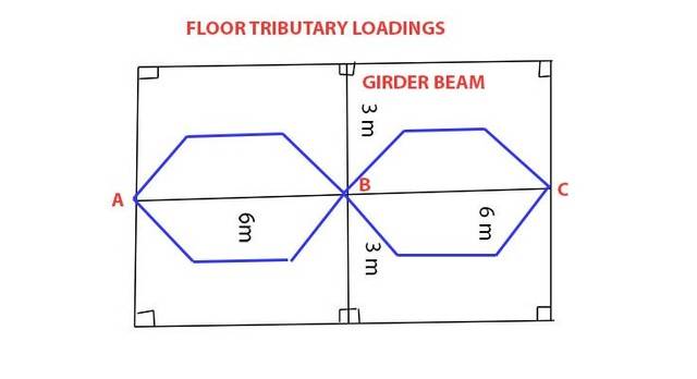

I've been solving something for a month as well as reading half a dozen structural engineering books. Maybe you can help.
Pinned and fixed supports can affect the moments and reactions.. for example.. a simple support pinned and fixed has the following moments...
pinned supports:
fixed supports:
You will noticed fixed support have more moments at the supports and less moments at midspan..
In structuring engineering.. you get the loads of the beam by the tributary areas of the floors or slabs.
In 3 pinned supports.. the formulas for the reactions are:
However, I can't get reference what would be the reactions if all the supports were fixed instead of pinned. The ends (A & C) would be have reactions and contributions to the load carrying if fixed than if they were all pinned. Any idea how to derive formulas for the fixed support cases?
Thank you.​
If an intermediate support is fixed then what happens on side of it cannot affect what happens on the other side, so the problem splits into two separate problems.
If R2 which is in the middle is fixed.. and R1 and R3 are pinned.. there are more reactions at R2. Whereas if R1 and R3 are fixed.. R1 and R3 can take more reactions. You are saying R1 and R2, R2 and R3 are separate problems? Hmm... Then let's just take R1 and R2.. what happened if R1 is fixed instead of Pinned?
But then the case is about 2 point loads at either sides and R1 formula is 5P/16 or 0.3125P, whereas R2 formula is 11P/8 or 1.375P. Now if all are fixed.. R1 and R3 should take more loads maybe 0.65P or sorta. I want formula to compute it.
Is it clear to you that, if the ends are pinned, the reaction forces are statically determinate? Is it also clear to you that, if the ends are "built in," the reaction forces and moments are statically indeterminate? Do you know the difference?
