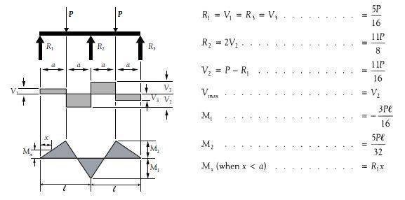

anyway.. I have been trying to derive these for a month but couldn't... in the following:
How is R1=R3=5P/16 and R2= 11P/8 exactly derived?

  • #34
Mohankpvk said:
I think its because, there will be more unknowns than the number of static equilibrium equations that can be applied.If both ends of a beam are fixed, you have to find two reaction meoments(one at each end) and two reaction vertical forces(one at each end).But you have only two static equilibrium equations.(summation of vertical forces=0 and summation of moment about any point=0).
No, there's more to it than that.
Consider the simplest case: no load applied, weightless beam, ends at same height and fixed horizontally.
If this is statically indeterminate then there must be a nontrivial solution, i.e., one in which the end supports apply equal and opposite nonzero vertical forces. Correspondingly there will be nonzero torques so that equilibrium is maintained.
For a theoretical rigid beam that would all be possible, but this field of study considers beams to be flexible. The beam undergoes a deflection y=y(x).
Suppose the supports give a force F up at the left and down at the right, and anticlockwise torques T, T' respectively.
Taking moments at offset x from the left:
ky"=-T+Fx
Integrating, and using y(0)=0:
ky'=-Tx+Fx2/2
Integrating, and using y'(0)=0:
ky=-Tx2/2+Fx3/6
Now we use the same constraints at the right hand end (x=L):
0=-TL+FL2/2
0=-TL2/2+FL3/6
When the smoke clears:
T=F=0.
So it is not indeterminate after all.
(I was wrong to agree to that earlier without checking.)

  • #35
Try applying the procedure I posted at #22 and #34.

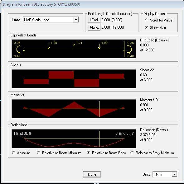

I'm using a structural software called ETABS or Extended 3D Analysis of Building Systems.
I'm manually verifying each computations and so far okay.. but I'm stuck on the determination of the reactions of the 3 points I mentioned earlier.
This is the input I made to the software.
I entered point live loads of 1 kN at each midspan. I didn't use dead load to avoid complicating with the concrete dead load.
The shear and moment diagram produced:
In the program, the fixed condition reactions at middle is about 60% and the ends 40%, whereas using pinned supports (supported by the formula), the reactions at middle is 11P/8 = 1.375 dividing by two is 0.6875 or 68.75% and end is 5P/16 = 0.3125 or 31.25%.
Using fixed supports, the ends have more contribution being 0.40 instead of 0.3125. Now how do you manually derive the 0.40 at fixed ends?
And what does the deflections have to do with it? There is a also a deflection output in the program.
Edit: I know deflections have a lot to do with the reactions but let's take first the concept of fixed vs pinned..

  • #39
about deflections I understood that
1) if an end deflects downwards, it will decrease the reaction at that end, increase the reaction in the middle, and decrease the reaction at the opposite end.
2) if an end deflects upwards, it will increase the reaction at that end, decrease the reaction in the middle, and increase the reaction at the opposite end.
3) if both ends and the middle support deflect the same amount, you're back to 5P/16 & 11P/8.
When an end is fixed.. how does it affect the deflections?
I know when it is moment connected at the end.. it has more reactions.. as shown by Etabs (see last message). I just wondered what formulas Etabs used to compute for it.

In structural books. They don't derive those formulas.. the torsion or torque I was referring to was about twisting of the concrete beam...
Anyway. About deflections. Is deflection just like the concept of moments where it can occur without any material properties just like I originally asked in my first message? In structural books. This wasn't made clear so most of us think moments and deflections are only related to the elements.
  • #57
No. The moment is the cause, and only depends on the load distribution. The deflection is the result, and depends on both the load and the properties of the beam.
  • #58
Well in the following derivations of 11P/8 and 5P/16 in the 3 supports pinned case.. there is no material properties of the beam so how did he derive using the deflection that has no material properties?
"one solution method:
Remove R2 (R2 is located at the centerline)
Deflection at R2 for the simple condition:
Pa/24EI * (3*l^2 - 4*a^2)
where: a = L/4
Pl/96EI * (3*l^2 - l^2/4)
Pl/96EI * (12*l^2/4 - l^2/4)
Pl/96EI * (11*l^2/4)
11*Pl^3/384EI
To restore that deflection
consider a single point load at R2:
R2 l^3 / 48*EI
set those two equations equal to each other and solve for R2
R2 = 11*P/8
from here it is simple statics to determine R1 and R3
Sum Fy = 0 -> R1 + R2 + R3 = 2P
Sum M1 = 0 -> R2*l/2 + R3 l - P*l/4 - P*3l/4 = 0 -> R3 = P - R2/2 = P - 11*P/16 = 16*P /16 - 11*P/16 = 5P/16
R1 + 11*P/8 + 5*P/16 = 2P
R1 + 27*P/16 = 2P
R1 = 2P - 27*P/16
R1 = 32*P/16 - 27*P/16
R1 = 5P/16"
  • #59
Ok, I can see why you are getting confused.
If all the forces and moments acting on the beam are known then the deflection depends on those and the properties of the beam.
In these problems, only some of the applied forces are known initially. The remaining reactions will depend on how the beam reacts to those.
If the beam is known to be uniform then we can figure out the shape of the deflection without knowing its extent. Halving the EI will simply double all the deflections. This allows us to calculate all the reactions without knowing the extent of the deflection.
  • #60
can you give example of a beam that is not uniform? do you mean not uniform in thickness or the rebars inside? so a uniform beam is one with identical rebars ratio and resistances in the whole length of the beam?
