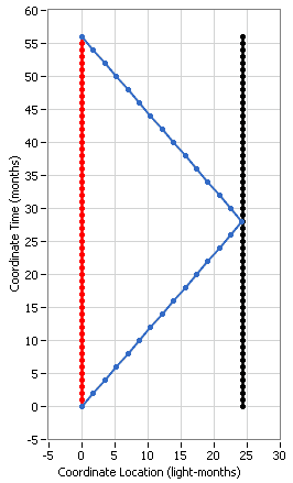

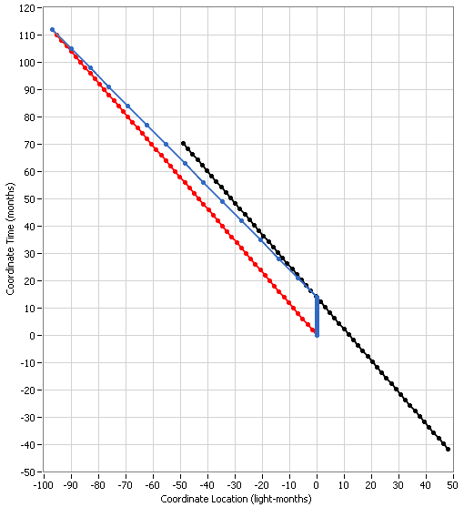

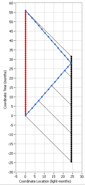

These four diagrams illustrate very clearly how Length Contraction is frame dependent:
In the first diagram depicting the rest frame of the stay-at-home blue twin, the black twin travels 9 light-months away and 9 light-months back.
In the second diagram depicting the rest frame of the black twin during the first "half" of the scenario, the blue twin moves away to a distance of 7.2 light-months and then the black twin has to travel 22.5 light-months to catch up to him.
In the third diagram depicting the rest frame of the black twin during the last "half" of the scenario, both twins are traveling but the black twin has traveled 22.5 light-months when he reaches his maximum distance of 7.2 light-months from the blue twin. Then he stops and waits for the blue twin to catch up to him.
In the fourth diagram depicting the non-inertial rest frame of the black twin, the blue twin travels away to a distance of 4.5 light-months, remains there for awhile and then returns.
In all of these diagrams, Length Contraction, Time Dilation and Simultaneity are different but the exact same Doppler information is maintained and the all-important speed of light is always c. Each twin always sees the other twin's clock running the same compared to his own throughout the scenario no matter what frame we use to describe the scenario. It's clearly presented. Why do you call it "terrible"?
