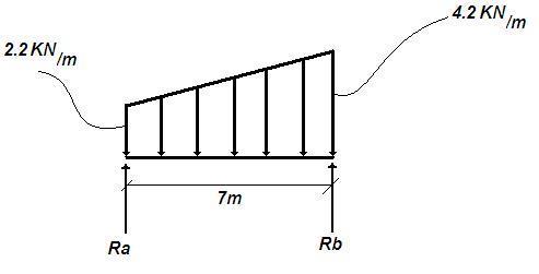

hi to all, i jst want to share my problem. it is a simple beam with trapezoidal loading on it. i resolve the trapezoid by making it into a uniformly distributed load and a triangular loading.. but still i can't determing how to solve or to draw the share and moment diagram.. using both the Equation Method and the Area Method.. can anybody share your genius idea? thanks here's the image of the problem
Let x be the distance from the left hand end.
Then Vx = ... and Mx=...? That is, what are the values of shear force and bending moment at section X, as functions of x. That is how to start.
