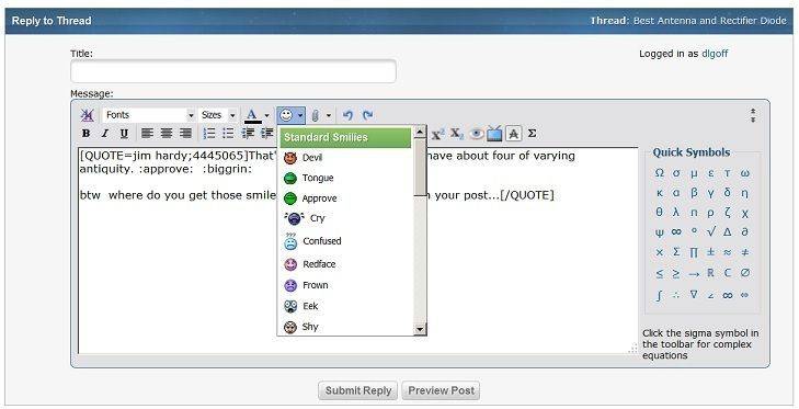

btw where do you get those smileys? I pasted 'biggrin' from your post...
jim hardy said:
That's where you find them. I have about four of varying antiquity. :approve: :biggrin:
Reply with "Go Advanced".
Forum reply editor showing the smiley picker dropdown open with the Standard Smilies list (Devil, Tongue, Approve, Cry, Confused, Redface, Frown, Eek, Shy) and the Quick Symbols panel on the right.
  • Forum reply editor showing the Standard Smilies dropdown open, listing Devil, Tongue, Approve, Cry, Confused, Redface, Frown, Eek and Shy, with a Quick Symbols panel on the right.
