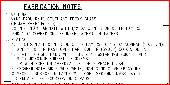

I'm designing a PCB with large exposed metallic pads for an experiment I'm running. The idea is I'll be able to solder directly and repeatedly onto the pads, so ideally the pads should be able to withstand multiple removals of solder.
Any thoughts on whether ENIG or bare copper would be better for this? Is there another finish I'm missing?

Here are some of the notes from the Fab Drawing for a board that I recently worked on. You could increase the thickness of the outer layer copper features if that would help to make the pads more robust...
