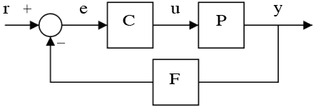

As for you diagram, I believe there is usually an input.
Which would the input be?
Energy is usually not modeled.
It is assumed to be universally present whenever you need it.
Here's a somewhat similar diagram, showing what I mean:
It also shows the basic elements (F=feedback sensor, C=controller, P=plant or system).

I meant that on the right side of the block diagram an arrow should come out representing the hot temperature (and if you want you can draw a figure warming his hands on that ;).
Femme_physics said:
I'm afraid you drew for instance Ue in the wrong place.
In the original diagram Ue and Ur are between different words...
And perhaps you can draw the reductor as a circle with a + input and a - input, just like in your transfer function diagram in your other thread.
I should to that to the right of Temp Sensor? Just add a box saying "HOT HOT HOT!"
Ah, I forgot I have Ue and Ur signified in the original diagram. Ok, all fixed :smile:

Not a block, but an arrow that points to "HOT HOT HOT!". ;)
Like in this picture:
Femme_physics said:
Oh my.
The circle is supposed to represent the Reductor.
And now you seem to have lost the Amplifier.
Btw, the scale should be connected to the circle.
And the + and - next to the circle should be where they match the connection in the original drawing.
(The circle is a summing junction. See my picture in this post.)

Uummm... but they are still not between between the words that they are in the original diagram... :confused:

Oh my.
I think I got it all straightened out now :smile:
http://img828.imageshack.us/img828/5637/hothotc.jpg
Yep! All rectified now! :wink:
Thanks! :smile:
