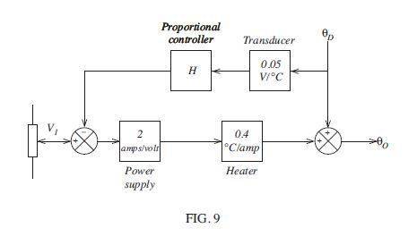

FIGURE 9 shows the block diagram of the control of an electric heatingsystem. The heater is driven from a voltage-controlled power supply, the
voltage V1 being derived from a potientiometer. The output temperature,
θO, is subject to disturbances, θD, because of changes in the ambient
temperature. It is proposed to apply 'disturbance feedback control' to the
system by the inclusion of a transducer that measures the external
temperature and feeds a signal back to the input via a proportional
controller of gain H.
Determine the required value of H to eliminate the effect of the disturbance.
Unsure
Unsure where to start.
  • Block diagram of a heater control system with a proportional controller H, a 0.05 V/°C transducer, a 2 amps/volt power supply, a 0.4 °C/amp heater, and disturbance input θD feeding a summing junction before output θO.
You could start by finding the transfer function from ##\theta_D## to ##\theta_O##. I'd suggest you replace everything in the boxes with symbols, so you get a general result without numbers and units mucking up your algebra - it's a useful habit.
Also, this is feed-forward control - there's no feedback path in that diagram.

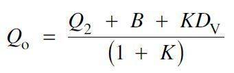

Would the following equation be used to help calculate the gain of the Proportional controller? I've attached the equation as a jpeg.
  • Equation for Qout as a function of G, B, KD, and K: Qout = (G + B + KD_v) / (1 + K), with the variables written in italic and the numerator and denominator on separate lines of a fraction.
I don't know what those symbols mean, and the image itself is frustratingly small o_O
I can't really help you if you don't show me what it is you're doing.
I'm a bit lost as we've never had anything like this question within the learning material. I've attached a larger image hopefully.
  • Equation: Qo = (Q2 + B + K DV) / (1 + K), where Qo is on the left and the right side is a fraction with Q2 + B + KDV over (1 + K).
I still don't know what the symbols in that equation represent. You'll have to tell me, and preferably also how you arrived at the equation.
I've attached the extracts from the learning material.
That's for a specific kind of feedback system. I think you'd be much better off if you tried to work out the algebra in this problem.
If we call the transducer ##T##, the power supply ##S##, and the heater ##A##, can you find an expression for ##\theta_O##?
One method is to just follow the signal pathway around as you write down the operations you encounter, e.g. you could start with ##\theta_O = \theta_D + \dots##, where you add the rest by following ##\theta_D## as it goes through the transducer etc. and back to the summing junction.
