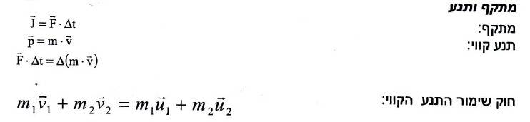

And they used a formula I haven't seen you using yet.
The one about impulse and momentum.
Hold on, I see it now.
Sorry, I made a mistake earlier.
The resultant force on the whale is (T-F), but this force will first accelerate the whale from zero to a certain speed, and after that it will decelerate the whale again, until it is back at zero speed.
This also means that the average acceleration is indeed zero.
On average this means that T and F are equal.
So your answer must indeed be F = 24 kN.
As for the formulas that were used, you have them on your list like this:
Hebrew page of physics formulas: impulse J = F·Δt, momentum p = m·v, F·Δt = Δ(m·v), and conservation of momentum m1v1 + m2v2 = m1u1 + m2u2.
If you want, I can explain how they were used.
  • Hebrew-titled reference sheet listing impulse J = F·Δt, momentum p = m·v, F·Δt = Δ(m·v), and the conservation of momentum equation m1v1 + m2v2 = m1u1 + m2u2.

Good morning, captain! :smile:And aha! it makes sense, then. :smile: Why did they use calculus notation though?
That doesn't really make much sense to me.
Ahoy ahoy sailor! :smile:
The calculus notation comes from the use of "impulse".
Impulse is a varying force that is exerted over a small period of time (the jerking tug in this case).
Typically it is unknown how the force varies exactly.
In cases we would know the varying force F, we would use an integral to sum it up.
That is [itex]J = \int F \cdot dt[/itex].
However, when you work with impulse, you're usually only interested in the total effect, which is the change in momentum. The force F is taken as an average then. Hence the formula [itex]J = F \cdot \Delta t[/itex] on your formula sheet.
Every now and then the calculus notation with an integral is still used to denote the impulse, although there is no intention of actually integrating.
Ah, I see :smile: gotcha. And thanks for the explanation, cap'n!
I really like the fact you took it out of my formula sheet :smile: !
