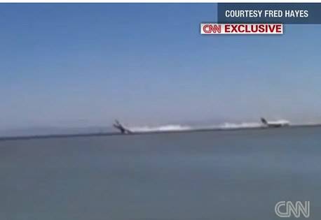

A video of the crash has surfaced. It was shot from about a mile away. You can see the plane doing a cartwheel-like reversal towards the end of its trip down the runway.
http://www.cnn.com/video/data/2.0/v...f-plane-crash-on-cam.courtesy-fred-hayes.html
That would explain the spinal injuries. Whiplash at 160+ mph. :cry:

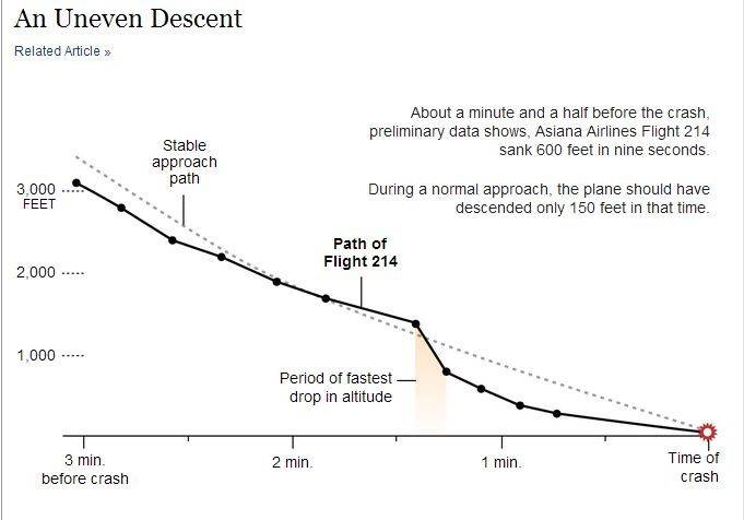

The flight originated in Shanghai with a stopover in Seoul. I don't know where the flight crew started. Seoul to SF is a long flight, 4AM to 2:30PM, so I can imagine fatigue might have been a factor especialy if they started in China.
Apparently the approach was steep and fast.
That runway (28L) has the 4 light glideslope visual indicators on the ground for the pilot to align himself vertically, like these,
EDIT: all red lights says the pilot is too low, these red & white lights mean this pilot is on glideslope. (these have changed a bit since my day).
Also the radio glideslope was out for construction so he had to land the plane himself instead of letting the computer track the radio signal.. It's sounding more and more to me like just a bad landing. If the visual indicators were out too I can have some sympathy for the pilot - it's easy to get rusty from over-reliance on automation.
This could be one instance where the computer would have done a better job.
