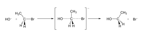

I think you are picturing a process like this:
reactants --> (bond breaking) --> transition state = individual species with all relevant bonds broken --> (bond formation) --> products
But does it have to follow that sequence?

Experimentally, or through QM only, you can't find it from typical thermodynamic data. And this is nothing unusual. Or perhaps I should put it differently - it is rather unusual to be able to calculate activation energy just from the thermodynamical data describing bond energies.

Hi Borek I suddenly started thinking about this again and I read the chemguide explanation. So what I got from it was that when the reactants collide with activation energy and correct orientation, the old bonds are partially broken at simultaneously new bonds are partially formed. But what happens after that transition state? Will more energy be absorbed to continue breaking those bonds?
