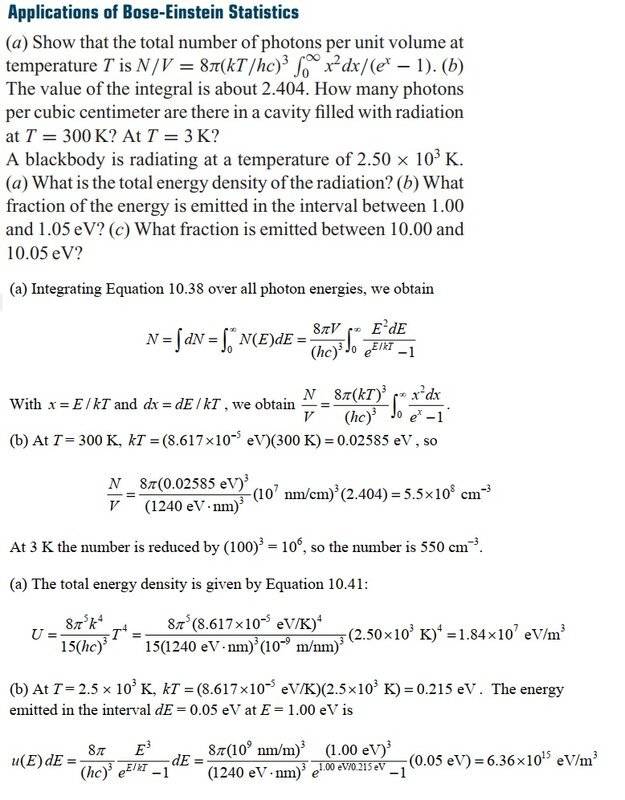

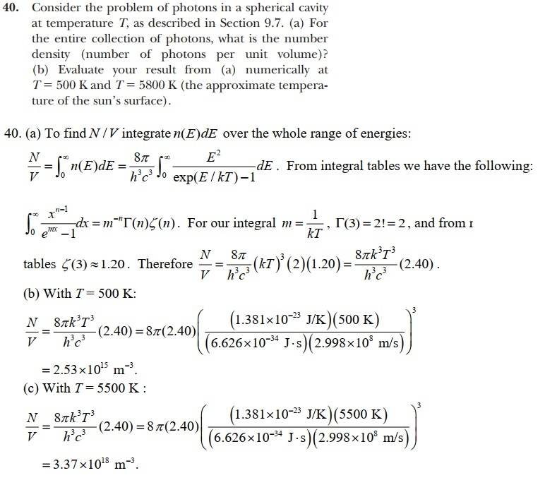

I don't see how it would make sense physically to integrate over temperature.TeslaPow said:Want to integrate the total energy density over all photon energies between two
temperature values from 500K to 5800K, but not sure how to proceed.
In any case, you have ##N/V = C T^3## [see the last line of the solution of 40. (a)], which shouldn't be too hard to integrate

By C you mean: 8 *pi * k / (hc)^3 ?

That should be ##k^3## and you forgot the ##\Gamma(3) \zeta(3) \approx 2.40## factor.TeslaPow said:By C you mean: 8 *pi * k / (hc)^3 ?

I don't understand. You said youTeslaPow said:So I also have to multiply the constant outside the integral with 2.40? What value will I use for T in the same equation on the left side if I integrate between 500K and 5500K ?
which I take to meanTeslaPow said:Want to integrate the total energy density over all photon energies between two
\int_{500\ \mathrm{K}}^{5800\ \mathrm{K}} \frac{N}{V} dT
So you simply need to integrate ##T^3## with the proper constant outside the integral.

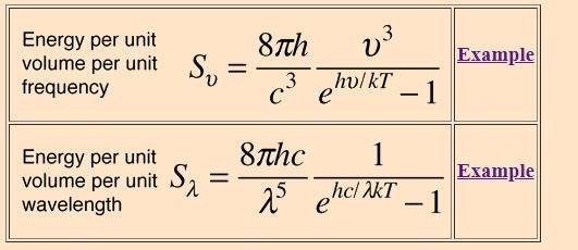

The energy density per unit wavelength is given in your post #6

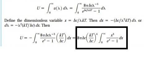

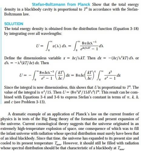

\frac{U}{V} = \frac{8 \pi h c}{\lambda^5} \frac{1}{e^{hc/\lambda kT} - 1}
so if you integrate over λ, the constant is ##8 \pi h c##.
However, if you make the substitution ##x = hc/\lambda kT##, then
\begin{align*}
\int_{\lambda_1}^{\lambda_2} \frac{U}{V} d\lambda &= \int_{\lambda_1}^{\lambda_2} \frac{8 \pi h c}{\lambda^5} \frac{1}{e^{hc/\lambda kT} - 1} d \lambda
&= -\frac{8 \pi (kT)^4}{(hc)^3} \int_{x_1}^{x_2} \frac{x^3}{e^{x} - 1} d x
\end{align*}
so the constant is ##-8 \pi (kT)^4 (hc)^{-3}##.

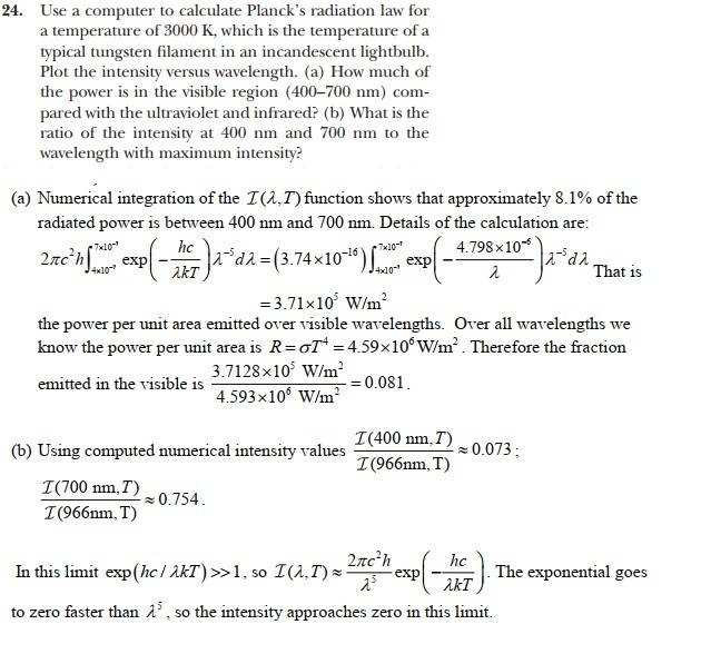

Last question, as for 24 b) in #10, the answer for the first intensity should be I(400nm,T) = 335289 W/m^2
https://www.wolframalpha.com/input/?i=solve(x/(4.593*10^(6))=0.073,x)
Just trying to plug in these values as in thread #11 but don't come up with the same answer.

Is this the right equation to use for the answer in 24 b) ?
DrClaude
Mentor
- 8,477
- 5,694
I don't understand what you are doing here. You seem to be calculating I(400nm,T) / (integral of I over all λ) instead of I(400nm,T)/I(966nm,T).TeslaPow said:Last question, as for 24 b) in #10, the answer for the first intensity should be I(400nm,T) = 335289 W/m^2
This is correct.TeslaPow said:Just trying to plug in these values as in thread #11 but don't come up with the same answer.
https://www.wolframalpha.com/input/?i=(2*pi*(299792458)^2*6.62607004*10^(-34))/(4.0*10^(-7))^(5)*e^(-6.62607004*10^(-34)*(299792458)/((4.0*10^(-7)*(1.38064852*10^(-23)*(3000)))))
