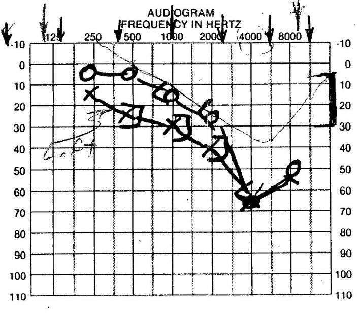

Back in 1986, I built a hearing aid. My father knew that he needed a hearing aid, but had a neighbor that had spent $1400 for a hearing that was unusable. He was not about to repeat that, but:
He could hear me clearly and easily.
He could barely hear my mother.
He could not hear the attractive young female bartender at his favorite bar.
He could not hear the attractive young female friend of the family, and needed my mother as interpreter to talk to her.
He could not hear Barbara Walters (TV person).
So he got an audiogram. This one:
Audiogram plotting hearing thresholds in decibels against frequency in hertz, with the left ear marked with O symbols and the right ear with X symbols, showing greater loss at higher frequencies.
So we set up an experiment. A microphone connected to an octave band equalizer with the gains set as indicated by the audiogram connected to a stereo amplifier set for maximum treble and minimum bass connected to headphones. This worked. He could hear the refrigerator, he could easily hear my mother doing her Donald Duck voice (don't ask), and no change in hearing me. He was now convinced that a properly designed hearing aid would give him the hearing that he wanted.
So I found a book titled Handbook of Simplified Solid State Circuit Design, in which was a circuit for an audio frequency bandpass amplifier. I ended up with a circuit in a Radio Shack project box that fit into a shirt pocket. That plus a tie pin microphone and ear buds resulted in a hearing that nicely met his needs. He took that to a hearing aid place, and they sold him a pair of hearing aids for $440 that met his needs.
So your device boosted the higher frequencies.
There is another approach that is taken for some types of hearing loss where the higher frequencies are remapped to lower ones.

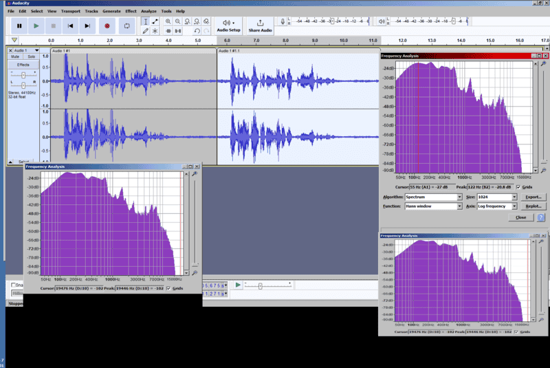

Up or Down-conversion of the spectrum or tone shifting is available on Audacity to shift the spectrum but only on recorded or generated sounds.
A compander can compress or expand with various attack/decay rates to accentuate and attenuate desired effects. If these improve SNR of voice by 6 dB this reduces error rate of voice recognition significantly or several orders of magnitude.
Listening to self and others can be different. Like wearing a headset.
My wife had fluid in her left skull bone which followed a left ear infection then 3mos later meningitus and 3mos of antibiotics. The fluid still degrades her s11 and s21 parametric response meaning her sidetone or own voice was 20 dB louder. But at least the CSF is not infected. Her left hearing was 30 dB down so her voice reduced naturally as her own voice was louder, then I couldn't hear her. I calibrate my ears with Audacity and a swept frequency on good speakers, but a credit card or a finger swipe on the skin is a (cheap N dirty) quick-test of white noise test for comparing left/right response and even calibrating levels of Tinnitus.
Down-conversion of spectrum is not a great enhancer. I tried 50 % and I sounded like those movies with people acting as disguise their voice (poorly.) Then tried 15% down shift and it can't say it sounded easier to recognize. on a log scale -15% shift of f is 1% of the 3 decade spectrum, so this is not helpful
Screenshot of Audacity showing two stereo waveform tracks of speech, with three Frequency Analysis spectrum windows in purple showing levels in dB against log-scale frequency from 50 Hz to 15000 Hz.

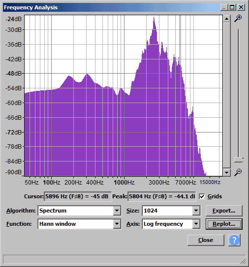

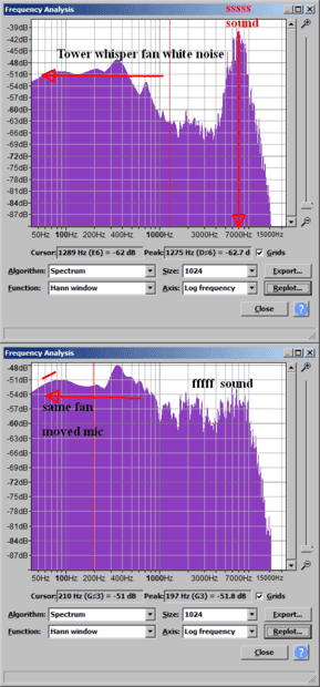

Communication Theory dictates the way to optimize detection or discrimination is always match the filter to the energy of the signal for passband and block the filter spectrum that is noise. This usually means a high pass filter. with 20 to 40 db per decade. You can see my near-field voice is concentrated between 100 and 800 Hz, yet "s's f's and sh's demand more gain the in the 3 to 7 kHz band for detection.
If one cannot hear well past 6 kHz then the sss sound will be diminished and sound the same as the ffff sound. which is last upper white noise on the lower plot.
Two frequency analysis plots in dB against log frequency: top shows a peak near 7000 Hz labelled sssss sound and a low-frequency hump labelled tower whisper fan white noise; bottom shows a flatter curve labelled ffffff sound and same fan moved mic.
  • Frequency Analysis window showing a Hann-windowed spectrum on a log frequency axis from about 50Hz to 15kHz, with dB levels from -24 to -90, peaking near 3kHz and falling off sharply above 7kHz.

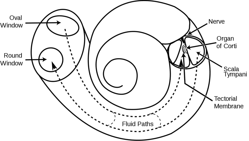

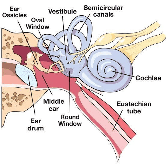

Our skulls do the same with opposite phase channel mixing to the ear drums.
There is a very clever mechanical structure in the Middle/inner ear interface. There are two 'windows' (diaphragms), one is in contact with an ossicle and the other is free. It is the difference between the two pressures that is processed by the cochlea.
Cross-section diagram of the human ear showing the ear drum, middle ear with ear ossicles, oval window, round window, vestibule, semicircular canals, cochlea and Eustachian tube.
Line drawing of the cochlea uncoiled, showing the oval window and round window on the left, the nerve, organ of Corti and scala tympani on the right, and dashed fluid paths running along the canal, labelled Fluid Paths.
Vibrations in the head vary the pressure in the middle ear and affect both windows in an identical way. The 'difference' is zero and it's only vibrations of the ossicles that get through. Those ossicles are a great example of an impedance matching transformer. Plus clever noise cancelling. The simpler image shows how the two sets of vibrations are processed an it's along the lines of an Op Amp with good common mode rejection. A blocked Eustachian tube can produce excess common mode signals and the cancellation no longer works - sounds unpleasant and alarming. This basic idea will be pretty familiar to an EE, as would be the use of dB and the concept of using numbers to describe performance. At the level of information I have found, there's not a lot of that!
