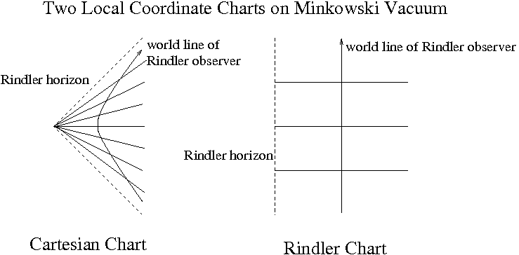

The Cartesian chart is convenient for many purposes, but there are several advantages to transforming to another chart which is "adapted" to the Rindler observers, namely the Rindler chart, which is only defined on the Rindler wedge (so it is certainly not a global chart!). The transformation we need is
[tex] \begin{array}{rcl}<br /> t & = & \operatorname{arctanh}(T/X) \\<br /> x & = & \sqrt{X^2-T^2} \\<br /> y & = & Y \\<br /> z & = & Z<br /> \end{array}[/tex]
The inverse transformation is
[tex] \begin{array}{rcl}<br /> T & = & x \, \sinh t \\<br /> X & =& x \, \cosh t \\<br /> Y & = & y \\<br /> Z & = & z<br /> \end{array}[/tex]
In the Rindler chart, the line element of Minkowski vacuum becomes
[tex] ds^2 = -x^2 \, dt^2 + dx^2 +dy^2 +dz^2,<br /> \; \; 0 < x < \infty, \; -\infty < t, \, y, \, z < \infty[/tex]
where [itex]x=0[/itex] is a coordinate singularity, the Rindler horizon, which corresponds to the boundary of the Rindler wedge [itex]|X|=T > 0[/itex].
In terms of the Rindler chart, the Rindler frame is
[tex] \begin{array}{rcl}<br /> \vec{e}_1 & = & \frac{1}{x} \; \partial_t \\<br /> \vec{e}_2 & = & \partial_x \\<br /> \vec{e}_3 & = & \partial_y \\<br /> \vec{e}_4 & = & \partial_z<br /> \end{array}[/tex]

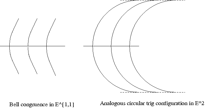

  • a hyperbolic trig configuration, the Rindler congruence, depicted in a Cartesian chart, and its circular trig analog,
  • a hyperbolic trig configuration, the Bell congruence, depicted in a Cartesian chart, and its circular trig analog,
  • comparing the Cartesian and Rindler charts.
  • Two side-by-side diagrams: left, a Rindler congruence in E^{1,1} shown as rays from a point with nested hyperbolas and orthogonal curves; right, concentric circles in E^2 with orthogonal radial lines. Captions below each.
  • Left: three nearly vertical curves bowing left, crossed by a horizontal line, labelled Bell congruence in E^{1,1}. Right: three concentric-looking arcs bowing left, crossed by a horizontal line with dashed tangent lines at top and bottom, labelled Analogous circular trig configuration in E^2.
  • Two side-by-side diagrams titled Two Local Coordinate Charts on Minkowski Vacuum: left, Cartesian chart with fan of lines from a point and a hyperbolic world line labelled Rindler observer; right, Rindler chart with horizontal lines and a vertical world line labelled Rindler observer, dashed Rindler horizon.

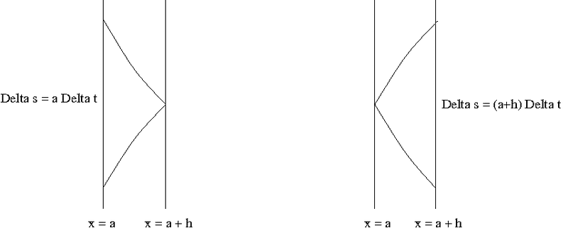

Let's work in the Rindler chart. The null geodesics obey
[tex] \pm x \, dt = dx[/tex]
or
[tex] \pm dt = \frac{dx}{x}[/tex]
Thus we can write null geodesics with constant y,z coordinate which pass through [itex]t=t_0, \, x=a[/itex] in the form
[tex] t = t_0 \pm \log (x/a)[/tex]
(See the figure below.)
Now let [itex]O_\hbox{low}[/itex] be the observer at [itex]x=a, y=z=0[/itex] and let [itex]O_\hbox{hi}[/itex] be the observer at [itex]x=a+h, y=z=0[/itex], where h is a small quantity. Then (see the figure below)
[tex] \begin{array}{rcl}<br /> \Delta t & = & 2 \; \int_{x=a}^{a+h} \frac{dx}{x} \\<br /> & = & 2 \log (1+h/a)<br /> \end{array}[/tex]
But the line element written in the Rindler chart shows that the proper time measured by the Rindler observer with coordinate [itex]x=x_0[/itex] scales like
[tex] \Delta s = x_0 \; \Delta t[/tex]
Thus (see figure) the radar distance from [itex]O_\hbox{low}[/itex] to [itex]O_\hbox{hi}[/itex] (measured by [itex]O_\hbox{low}[/itex]) is
[tex] \begin{array}{rcl}<br /> \frac{\Delta s}{2} & = & a \; \log \, (1 + h/a ) \\<br /> & \approx & h - \frac{h^2}{2a} + O(h^3)<br /> \end{array}[/tex]
But the radar distance from [itex]O_\hbox{hi}[/itex] to [itex]O_\hbox{low}[/itex] (measured by [itex]O_\hbox{hi}[/itex]) is
[tex] \begin{array}{rcl}<br /> \frac{\Delta s}{2} & = & (a + h) \; \log \, (1 + h/a ) \\<br /> & \approx & h + \frac{h^2}{2a} + O(h^3)<br /> \end{array}[/tex]
This shows (and its obvious once you see it) that radar distance is not symmetric, but this issue only shows up at second order in h, where h is the pedometer distance in the hyperslice t=0 which would, naively, be measured by an observer who very slowly walks from [itex]x=a+h[/itex] to [itex]x=a[/itex] along [itex]y=z=0[/itex].
A similar computation shows that radar distance is not additive, even for "colinear" Rindler observers.
Figures (left to right):
  • Radar distance is not symmetric
  • Two spacetime diagrams of vertical lines x = a and x = a+h joined by null geodesic curves; left shows Delta s = a Delta t, right shows Delta s = (a+h) Delta t.

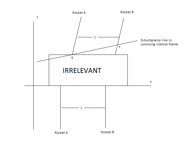

I would say that it's much easier than that. First consider the following version of Bell's spaceship paradox: (I won't describe the string; you know that part). Let S be an inertial frame. Unless I say otherwise, all the coordinates I mention are components of S. Consider two rockets that at t=0 are identical in every way, except for being located at different x coordinates. The coordinate distance between them at t=0 is L. Each rocket is equipped with a clock and a computer that controls the engine. The rockets are at rest for all t<0. At t=0, the engines are switched on, and at some later time they are switched off.
The requirement that the rockets are identical implies that the world lines of the rockets are identical too, except for their positions. (The clocks are synchronized and the computers are running the same programs; otherwise the rockets wouldn't be identical). More precisely, if [itex]A:\mathbb R\rightarrow M[/itex] and [itex]B:\mathbb R\rightarrow M[/itex] are the world lines, and [itex]S:M\rightarrow\mathbb R^2[/itex] is the coordinate system, we have [itex]S\circ B(\tau)=S\circ A(\tau)+(0,L)[/itex]. The spacetime diagram associated with S looks roughly like the image I have uploaded. The coordinate distance between the world lines is =L at all times (even though I wasn't able to get that exactly right in Paint). The lines I drew above the IRRELEVANT box just show one example of what the world lines might look like after the engines are shut off. They must be timelike geodesics; they must start at events that are timelike separated from the events where they engines are switched on (at t=0); they must be a coordinate distance L apart (at each t above the box). But apart from that, there are no restrictions on what they can look like.
Now consider a simultaneity line of the comoving inertial frame at an event E on A's world line above the box. Let F be the event where it intersects B's world line. The length contraction formula tells us that the distance in the comoving inertial frame between E and F is gamma*L. So a string that's at rest in this inertial frame (in which both rockets are at rest), can't be attached to both rockets unless its length is at least gamma*L>L. The string we attached had rest length L and couldn't be stretched to a longer rest length, so it must have snapped.
Now consider the scenario with constant proper acceleration that goes on forever. How would that change the spacetime diagram? We only need a small part of the answer: It would bend B's world line to the right. That would make the simultaneity line longer than in the first scenario, so the string must break in this scenario too.
This is a complete resolution of both the scenario with constant proper acceleration that goes on forever, and a scenario with an arbitrary acceleration pattern, and it doesn't require the reader to understand frame fields, the expansion tensor, or any other techniques based on differential geometry. He/she only has to understand simultaneity and length contraction.
Spacetime diagram with t and x axes showing two parallel worldlines labelled Rocket A and Rocket B, separated by coordinate distance L, with a simultaneity line through events E and F.
The text should say "simultaneity line of comoving inertial frame"
  • Spacetime diagram with horizontal x axis and vertical t axis showing two parallel worldlines labelled Rocket A and Rocket B, separated by distance L at both the top and bottom, with a slanted simultaneity line through events E and F.
