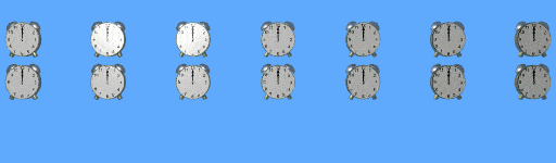

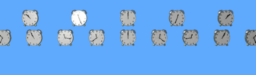

Before I asked my first question on PhysicsForums, I had worked through an interesting conundrum. We have a line of A objects equally spaced and in the same inertial frame. We have a similar line of B objects so that each A object is adjacent to a B object. B objects are all in the same inertial frame, but a different frame than A. It appears that A's and B's will all be in conjunction at regular intervals.
I was able to figure out on my own that this could only be the situation from one viewpoint. In the other frame, A's (or B's, depending on the viewpoint) would be closer together and conjunctions would not be simultaneous at all.
I have switched terminology and specifications several times, so even I'm not sure who's who and what's what. The idea for the video was to have an infinite line of B's trailing a lead B so that there would be one B always adjacent to A. The thinking is that this would be equivalent to calculating a light-delay-corrected video as per a boring mapping I detailed a while back. It isn't because of relativity of simultaneity problems. That's sufficient for me at this point, I can work the math later.
Thanks for working though all this with me.
Freixas said:
Well, it's nice to be right about something!
You mean something like this:
Such as when when you switch to the frame for the top row of clocks, and get this:
I'm puzzled by this animation. The clocks are small and I can't single-step through it, but aren't the clocks in the top row running at the same rate as the ones in the bottom row? Shouldn't they be running slower?
For this particular set of animations, I assume that the clocks in the upper row have had their tick rates adjusted so that they match that of the clocks in the lower row as measured from this frame. That way, as any clock in the top row passes a clock in the lower row, they read the same time.
Then when we switch to the frame in which the upper row is at rest, we see that, even though the clocks are all out of sync with each other, the lower clocks run slower than the upper clocks, and the lower clocks are closer together, whenever a lower and upper clock pass each other they still read the same time.
