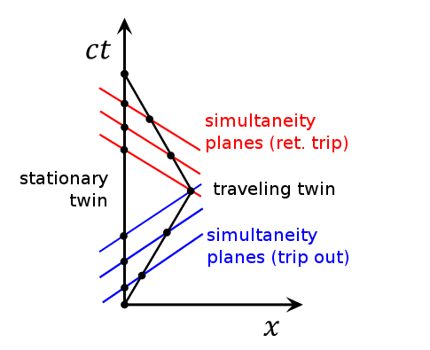

Here is a diagram from the Wikipedia. I'm sure you understand what this represents. Those who don't, can go to the Wikipedia page (https://en.wikipedia.org/wiki/Twin_paradox) and see all the details.
Minkowski spacetime diagram with ct on the vertical axis and x on the horizontal axis, showing a stationary twin's vertical worldline and a traveling twin's worldline that goes out and returns, with dots marking events and red and blue simultaneity lines for the return and outbound legs.
After my prior post, I have a better appreciation for simultaneity. Originally, when I looked at this diagram, I looked at it using the common meaning of "simultaneous". I thought it was telling me that where the red and blue lines cross the space time lines of the stationary and traveling twins, the twins exist in the same moment from both twin's perspectives.
My insight is that the correspondence is just for the traveling twin. The stationary twin will draw different lines. The word (on the chart itself!) "simultaneity" really tripped me up. I'll be honest; even when the diagrams included the stationary twin's idea of simultaneous, I didn't really understand what I was looking at. There's seeing and there is understanding.
I'm sure this is so ingrained with experienced physicists that they may not understand why throwing these diagrams at beginners doesn't make things crystal clear. I mean, you even tell the poor beginner what the lines means and he still doesn't get it. Diagrams like this that omit the other twin's simultaneity lines tend to support the wrong idea.
Yes, there is a question here. Two, actually.
The diagram above assumes the traveling twin can change directions instantaneously. I want to check my understanding. The stationary twin can look at a giant clock attached to the traveling twin. He records the clock and then corrects the recording for light delay. I believe he sees the traveling twin's clock running slow by the same factor on each leg of the trip.
The stationary twin also has a clock that the traveling twin can record. The traveling twin corrects his recording for light delay. He also sees his stationary twin's clock running slower and by the same amount on each leg. However, at turn-around, he sees his twin's clock jump forward in time. Do I have it right or am I still missing something?
The re-alignment of the spacetime axes of the traveling twin resolves the twin paradox. But I realize I still have a hole in my understanding. If any frame can be considered the stationary frame, is there some perspective in which the traveling twin could assume he was motionless for the whole trip and that the "stationary" twin went out and back? (By the way, I have seen a video that showed just that: the traveling twin stationary while the Earth moves back and forth and claiming that, since everything is relative, either viewpoint is equivalent.)
Could we redraw the Minkowski diagram from the traveling twin's point of view?
My own attempt at an answer is that, if you change your frame, you can't treat it as though you are motionless and everyone else changed frames. Even if you had an inertialess drive and could switch directions instantly, you could still tell that you changed direction and not the rest of the universe. And if you wanted to draw a Minkowsky diagram for the traveling twin, you would need two, one for each direction.
I can say those words, but I have to admit to not having an intuitive understanding of why it's true. My best guess is that maybe inertialess drives are impossible because it would create this very confusion. Someone who didn't see the inertialess drive activated wouldn't be able to tell if they just experienced a change in direction or the rest of the universe did, and the twin paradox would turn into a real paradox. You can't resolve it if everything is symmetrical. Everyone has to be able to agree that the traveling twin was the one who changed direction.
Corrections and clarifications welcome.
There is such a frame, but it is not an inertial frame so none of the straightforward equations like the time dilation formula can be used to compare times registered by a clock at rest in that frame with times registered by the Earth clock.
The best way to understand what each twin sees is by working through the Doppler Effect explanation in the Twin Paradox FAQ: http://math.ucr.edu/home/baez/physics/Relativity/SR/TwinParadox/twin_paradox.html. Just imagine that each flash of light is actually an image reflected from the clock at the source (or equivalently, a radio message reporting the time on that clock when the message is sent). For simplicity, assume that the turnaround is instantaneous and happens between flashes (any other assumption complicates the picture but introduces no new physical insight).
You can be very insistent on doing that, and just put the entire path of the traveling twin on a straight line. But, as mentioned by Nugatory above, since the traveling is necessarily changing inertial frames, doing so introduces a discontinuity as shown on the second of the three graphs in the link below:
http://www.einsteins-theory-of-relativity-4engineers.com/twin-paradox-2.html
The discontinuity is there because the outbound and the inbound trips of the traveling twin are objectively different inertial frames, with non-zero relative velocity, so the graph showing them both on one straight line is just two different graphs glued together. Compare with the third graph in the link to see the situation from the inbound trip perspective. You should see the half that makes up the inbound part of the second graph.
This question is not as straightforward as the previous one. The reason is as follows:
In the case of the stationary twin the correction for light delay is simple, the first postulate says that the speed of light in vacuum is equal to c in any inertial reference frame. However, the traveling twin's frame is not inertial so it is not clear how to correct the observations for the light delay. The simultaneity convention used above is what I call the naïve simultaneity convention, and it simply uses the momentarily co-moving inertial frame's definition of simultaneity. In the "gap" and in the "overlap" regions the speed of light is no longer c, in fact all speeds of all objects in those regions are undefined.
One alternative is to use radar coordinates, which avoids those problems and results in a non-inertial reference frame where the speed of light is still c at all events. However, the drawings are a little different and can be surprising:
https://arxiv.org/abs/gr-qc/0104077
Note, this is not the only alternative to the naïve simultaneity convention, but it is one that I personally like.

I know I have two questions. Let me try to clarify the first.
I like the video transmission idea, with corrections for light delay. That means that one can't really review the video until the trip is complete. The trip takes 10 years for the Earth twin, 6 for the traveling twin. The traveling twin always sees his Earth twin's clock running slow at a constant rate. Therefore, the traveler has a video recording 6 years long that shows less than 6 years passing on Earth. But the recording shows Earth 0 and the start and Earth 10 at the end. So, to my simplistic mind, the video should show a discontinuity.
If instead of a constant velocity and an inertialess turn-around, we use more typical acceleration, we can steal this diagram from Wikipedia:
TwinParadoxProperAcceleration.svg
This one show simultaneity from both viewpoints. Between traveling twin's years 4 and 5, it looks like time would appear to be running faster for the Earth twin than the traveling twin.
The radar approach doesn't seem to forbid the speed-up. I have to confess that most of the paper makes my eyes glaze over, so I can't be sure what Figure 5 represents. In Region I, which appears to be the region I am most interested in, it sure looks like the lines of simultaneity (from Barbara's view) make it so that Alex's clock runs faster than Barbara's.
The thing that attracted my attention to this is that the first concept one hears is that each observer views the other's time as running slower., so it's only at the turn-around that I'm seeing cases where that's not so. Or appears not to be so.
As I am more an engineer than a mathematician, it seemed like recording the whole thing on video should make it all clear. Ibix said "The problem is that it's non-trivial to correct for light travel time near the turnaround." and Dale doesn't like inertialess drives. How about the following?
