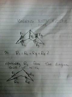

The following question is from my second semester physics class at UC davis.
2. The attempt at a solution
The reason I'm having trouble with this is because usually with circuits, we can usually tell right away if the problem is in series or parallel. This is confusing to me because I have no idea how to tell if it's in series or parallel. Does it matter which way I view it from? I tried to draw this out schematically but it still just doesn't make sense. I assumed that the middle three resistors were in series while the outer three resistors were in parallel but the answer I got doesn't match up to the answer on the answer key.
If anyone could please help me with this problem and not simply tell me what the answer is, but HOW you got the answer, it would be greatly appreciated! THANK YOU!

Ok the bottom resistor is indeed connected in parallel with the battery. That means the current through it is fixed and changing the value of that resistor has no effect on the current through the other resistors. So that resistor can be ignored for the moment. Concentrate on the others...
If the other resistors all have the same value then (by symetry) the voltage at each end of the vertical resistor is the same. If the voltage drop across a resistor is allways zero then no current flows through it. You could remove it or replace it with a wire and it would have no effect on the rest of the circuit. So remove it from the diagram and see what you are left with.

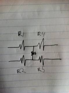

Instead of drawing it as a triangle, think of the top 5 resistors as connected in two horizontal lines, with the vertical resistor bridging the middle. The bottom resistor directly connects with both terminals of the battery. So if you can collapse the top 5 resistors and find its equivalent resistance, you'll be able to find the equivalent resistance of the entire circuit.
Looking at it that way, what do you notice about how the upper left two resistors and the upper right two resistors are connected? Can they be collapsed?
CWatters this is what I'm left with. I'm confused as to the significance of leaving out the middle resistor.
Arghzoo:
what i notice about the other 4 resistors is that they are in parallel circuits. What do you mean by collapsed?
A critical piece of information I left out was that the resistance of each resistor is 10 Ohms. I'm not sure what to do from here really.
CWatters brought up the most important part: if the voltage at the ends are equal, no current can flow, and there might as well be empty space there. So, then the two top resistors and the two bottom resistors... Can be effectively "collapsed" into one top and one bottom.
By "collapsed" I'm talking about how the resistances of two or more resistors connected in a particular way can be made into one resistor with a resistance that represents the resistance of all of them
So is what you're saying is that I can collapse resistors 1/2 and 4/5? and the resistance of them altogether would still be 10 ohms? what about resistor 3 and the initial resistor that was connected to the battery? I'm having a hard time understanding what my overall picture would look like. also, in advance, I appreciate the help.
If you've gotten to the point where you know the rules for resistors, they should tell you how to find the equivalent resistance of two resistors in series and in parallel. 1 and 4 are series, and so are 2 and 5. They're directly connected to each other. In this process, you can reduce the entire problem into one equivalent resistance.

Click this link : WHEATSTONE BRIDGE
The thing is, the resistors R1,R2,R3 and R4 are satisfying the balanced condition of wheatstone bridge (Their arrangement). Therefore, the potential difference across R5 becomes zero and no current flows through it. Therefore, it can easily be removed without affecting the overall circuit. Since there is no current, it is of no use in circuit. That's what other meant to "collapse" it.

IF they are the same value then your last diagram is correct. The vertical resistor has no function and can be removed or shorted out. Then the circuit reduces to
(two resistors in series) in parallel with (two resistors in series) in parallel with (one resistor).
