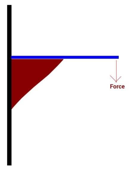

Hello,
I am trying to support a shelf with a block of wood. The block of wood is only 3 inches deep and the shelf 2 feet deep. If the block of wood is capable of supporting 500 lbs, how much weight can the shelf support if the force is applied downward at the edge of the shelf?
This is a real world problem not a homework problem, would appreciate help in calculating this (i.e. what formula should I use).
Impossible to say without a diagram showing exactly what you are talking about
Black = Wall
The red block of wood is 3 inches deep
The blue shelf is 2 feet deep
Still not anywhere near enough information. Where and how is the triangle attached to the wall? How are the two pieces of wood attached to each other? You say that the shelf can support 500 lbs but you don't say how much torque can the wall studs can support. Even if you assume they can support whatever is needed, the other information is still required.

The block of wood is in the middle of the shelf. The shelf is 3 feet wide and 2 feet deep, it is supported in the middle of the shelf. I'm going from the block of wood into the studs with two screws at a 90* angle. From what I understand each screw is capable of supporting >500lbs. I have about 1.5" of the screw going into the stud; which is a standard #8 screw. The wall screws will give out before the studs will.
I was trying to simplify this equation, so if you'd like, assume that the shelf is only as wide as the block of wood (i.e. no x-axis).
I hope that helps, and thank you.

OK, that helps. I think basically you are saying that all joints should be taken as capable of supporting whatever load is applied. That's not unreasonable although your statement that "each screw is capable of supporting >500 lbs is not as helpful as you seem to think it is since what it means is that if the force were applied directly in parallel with the screw, which is not quite what we have here, although it's close if you put the top screw as high up as possible in the triangle. The bottom screw will really only be used for shear stress so it's holding capacity is irrelevant unless it is just below the top screw , so they entire load is supported by one screw that can hold something that is an unspecified amount more than the expected load. With the force applied two feet away from the screw, the torque will likely (I haven't done any computation) be several times the 500lb load, so the screw will pull out.
THEN you totally change the problem by going from a force applied two feet out to a force applied directly over the supporting brace. In that case it will probably hold, although if you really only have one brace under the middle of the board, any lateral imbalance in the load will cause a whole 'nother set of problems.

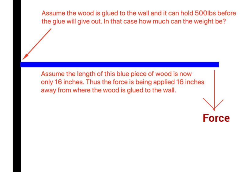

I'm not looking for exact numbers so what if we overly simplified this problem as follows (see image). Does that help?

I'm not looking for exact numbers so what if we overly simplified this problem as follows (see image). Does that help?View attachment 231431
Yes, that's a simple one. With no further support other than the glue at the back of the plank, and assuming a 3/4" plank, the torque on the glue joint will be at least several thousand pounds and the joint will fail.
