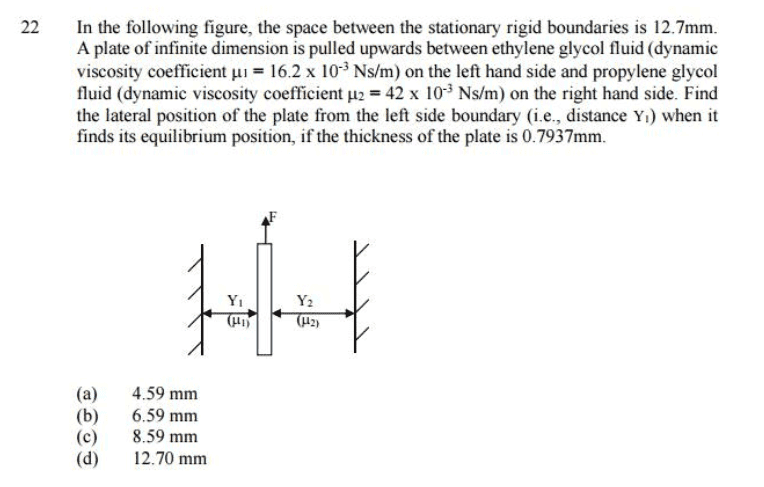

Problem is as shown in the picture.
Textbook figure of a vertical plate between two rigid walls, labelled Y1 with viscosity mu1 on the left gap and Y2 with mu2 on the right gap, with force F acting upward on the plate.
The answer is meant to be a 4.59mm.
Tau=mu(du/dy)
Force (tau) acting on plate from both fluids is equal, as is velocity (du).
mu1 (du/dy1) = mu2 (du/dy2)
mu1/dy1 = mu2/dy2
(mu2/mu1) *y1 = y2
y1 + y2 + plate thickness = width
y1 + y2 + 0.7937 = 12.7 mm
By substituting in mu2/mu1 *y1 = y2 I obtain the answer y1 = 3.31 mm.Any help is much appreciated
Who says that the force (or shear stress) exerted by each fluid on the plate has to be the same? It seems to me this problem is under-specified.
