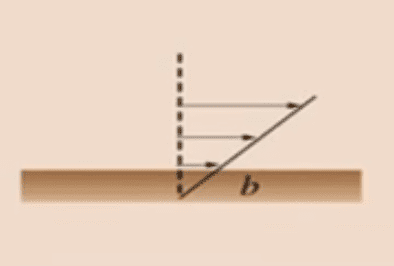

In order to improve my understanding, I searched for a diagram that illustrated the phenomena, which shows (apologies for the low quality) :
This ##b## distance in the diagram is the ##l## of my equation at the top. So I am wondering if it should be included as part of the ##dy## term, as ##dy = h - l## or should it be part of the ##\partial y = h - l ## or if my original analysis was correct?

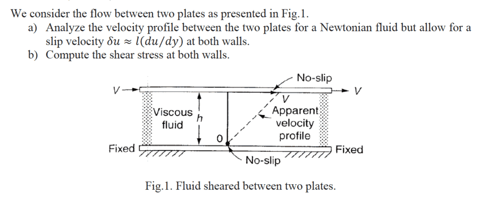

Can you render the actual problem statement in full?:
The diagram says *No-slip* but that is a typo (the teacher said so).

I see. In that case your picture is sensible and something similar occurs at the top plate.
Effectively ##h## is increased by ##2b##. Arguing that ##\tau## is a one-side derivative is thin ice, but I suppose that's what is meant.
I see, that makes sense. Would you say du/dy is the usual slope V/h ? While ##\partial u / \partial y ## accounts for the velocity V affected by slip and the "new" height, such that ## (V - 2\delta u)/(h + 2b) ## ?
Not both.
I get a fluid velocity at y = 0 of ##u(0)=l\gamma##, where ##\gamma## is the shear rate. And, at y = h, I get a fluid velocity of ##u(h)=V-l\gamma##. So, for the shear rate, I get $$\gamma=\frac{u(h)-u(0)}{h}=\frac{(V-l\gamma)-l\gamma}{h}=\frac{V-2l\gamma}{h}$$Solving for ##\gamma## gives:$$\gamma=\frac{V/h}{\left(1+2\frac{l}{h}\right)}$$
What do you guys think?
That is correct Sir, I think. By doing ##\delta u = \ell du/dy = \ell V/(h+2l) ## we can arrive to the same form.
Thank you!
