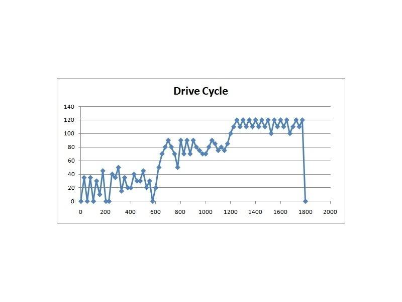

I aggree with you that at 50mph that i would need more energy.
However if you look at my drive cycle below you will reaslise that it will not do this average speed for 100miles continuous.
I am trying to compile a spreadsheet of the powers required to accelerte the vehicle and the resistive forces throughout.
The dominant force is not drag, the force required to accelerate the vehicle is allmost allways dominant.

Units? Speed in km/hour vs seconds? No regen braking to capture that energy when you decelerate?

Ok, sorry on that graph, the x-axis is seconds, the speed is in kph. I am leaving regen braking out for now, ill wait until i can get a reasonable answer for just normal battery drain. Plus i have no idea about the effienency about how much energy from braking can be converted into electrical energy and stored!
