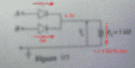

Proff Young
http://img545.imageshack.us/img545/7113/diodeq.jpg
In the circuit shown in the figure (c) above if VA=5V and VB=3V, calculate the current through RL.
Please explain.

Thank you but pardon me. I cannot grasp what is written on the image. It's not clear. And what if the diodes have a Barrier voltage of 0.7V each.
Thank you.
I'm sorry, but I thought you preferred really really poor picture quality. Anyway, assuming a diode voltage drop of 0.7V is a good start because by doing that you'll soon enough run into a contradiction (of sorts) and see that one of the diodes is reversed biased. Think about it some more and you'll see it, I'm sure.
EDIT: SchemeIt is a good alternative for drawing circuits. It's free and very easy to use. Check it out!
I got the idea thank you. If VA=VB=5V and if the diodes have a barrier voltage of 0.7V each then voltage across the resistor will be 4.3V. Am I right?
Assuming you're using standard silicon diodes (voltage drop about 0.7 V), the current that flows through RL is 4.3 mA, only diode A conducts and diode B is reverse biased.
Proff Young said:
If VA= VB= 5V and if the diodes have a barrier voltage of 0.7V each then voltage across the resistor will be 4.3V. Am I right?

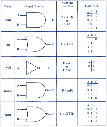

Yes. By the way, your circuit is also functionally equal to a _____ gate. Do you know which one?
P.S Let a logic '1' be any voltage > 4.3V and a logic '0' be any voltage < 4.3V. The gate output 'F' from the figure above would be the node between the diodes and load resistor.
I hope it is the OR gate. Thank you for helping, I have a better idea now.
