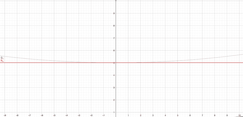

Using the original numbers of 9 lbs. per 1000 ft, converting to metric units, I get that a one mile cord (1.6km) sags 12m with the tension equal to 825 lbs or 3670N. To get the sag down to 0.12m or about 5 inches the tension would rise 100 fold to about 37 metric tonnes. Of course it would break long before that. Including the 100% stretch might halve that but I think it's still way beyond the bungee cord specs.My conclusion is that you will have to find another way to create the illusion of framing these sculptures. I like @DaveC426913's idea of using laser light. It reminds me of this artist using laser beams to make 'intergalactic sculpture'. You could literally use smoke and mirrors.
