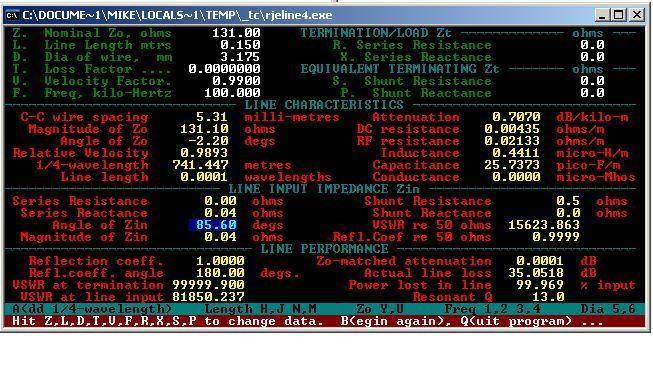

How would I calculate or estimate the inductance of a given pair of rails? FYI, they are 0.0625 inches wide, 6.0 inches long and 0.25 inches high, being separated by 0.125 inches.
I have had only a brief introduction to calculus, therefore I'm not entirely sure what to do with the "L-prime" factor, which is measured in henries/meter. I know that inductance is measured in henries. Would I simply take the total inductance of the rails, in henries, and divide this by the length of the rails, in meters? If so, why is the considered "prime?" It seems that I remember when something was prime we applied the "power rule" to it, in my former calculus class, that is.

I think that inductance figure would be much too high. A Henry is actually quite a big unit.
I'd be surprised if your rail has an inductance of more than 5 microhenries / meter.
Don't know if it would help, but I am attaching a great program that is intended for use with transmission lines. It was written by Reg Edwards G4FGQ, now deceased.
You will need to work out the Characteristic Impedance of your line.
Z = 276 log (2 * (distance between lines, centre to centre) / (diameter of conductor ))
Units just have to be the same.
My best estimate was 131 ohms.
I ran this program and I get an Inductance of 0.44 uH per meter using a shorted end on the rail. You might like to try it. I had to guess a bit with the input data. :)
Yes, looking back my mistake was using .5H instead of .5uH. Foolish me!
