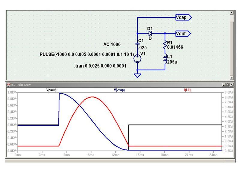

Hi Bob, i appreciate the follow-up. I have done quite some homework before on a magnetizer, especially what the manufacturer has told me. We have on hand a Sine-Half Wave Magnetizer, which typically produces only a half sine wave magnetic pulse to any connected coil.
The magnetiser internal inductance and resistance is unknown. This information is not disclosed to us nor will it ever be ( i think...). I have absolutely no idea on how to perform my own measurements to get them.
From the schematics, there is a diode in series with a scr, connected to one of the outputs. So the answer to your question, it should be a YES, there is a diode to block the reverse polarity. The capacitors are bipolar and there is NO label on the caps, so no way to know who manufactured them too.
I just hope that i am not going in the wrong direction :-p
Hi Nash-
I put a generic diode in, and it seemed to work. See thumbnail. Black is coil voltage, left scale. Red is current, right scale. Blue is capacitor voltage, left scale.
NOTE that there is voltage left on the capacitor after the pulse.
Bob S

Dear Bob,
Your example makes perfect sense.
SO all the calculations have been right! Maybe i should have better confidence in what i am doing...
All i need to do is to get the resonant frequency and divide it by 2.
Amplitude just depends on the voltage upon the pulse into the coil, that is for the later part which i will try to calculate how much heat my coil dissipates at each pulse.
I greatly appreciate your help! And in return, i will post my later findings for sharing with the rest of the forum members.
PS: Is your software freeware or those expensive ones?
Rgds
Nash
Hi Nask-
1) To get the pulse width of half cycle, calculate resonant frequency, get reciprocal to get period, then divide period by two.
2) To estimate the peak coil current, equate stored energy in capacitor and in coil:
(1/2)CV2 = (1/2)LI2
Using C=.025 F, V=1000, and L = 295 uH. I get 9205 amps peak.
3) Software is FREE! I am using LTspice IV from www.linear.com.

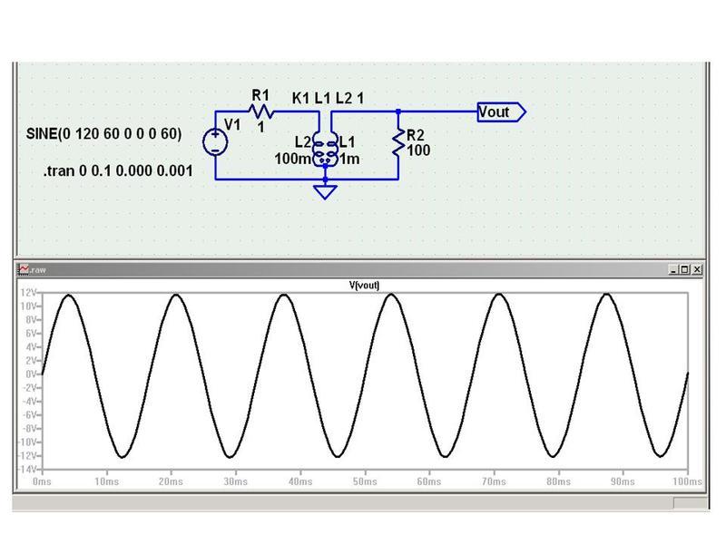

Hi Bob,
Im beginning to use LT Spice, is there any transformer and bridge rectifier component somewhere? I can't seem to find them.
Thanks to you, I'm completing my work soon.
Really appreciate the help. :redface:
Rgds,
Nash
High Nash-
For a bridge rectifier, I would use 4 generic diodes, or you can choose a specific diode from a list. I have not tried it, but for transformers, you use a spice directive and two inductors (with the polarity circle) back to back. The relative inductance is the turns ratio squared. See HELP in the top toolbar, then type "transformer" in the search box.
Bob S
[Edit] I added the attached thumbnail jpg showing a 10:1 (120 volt to 12 volt) transformer using a spice directive (under Edit in top LTspice toolbar).
Bob S
