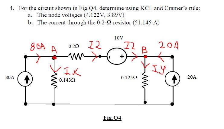

I'm not getting the correct answers, here are my equations
Node A:
80 = ix + i2
80 = Va/0.143 + (Va-(Vb+10))/0.2......1
Node B:
20 = iy-i2
20 = Vb/0.125 - (Va-(Vb+10))/0.2......2
Are these equations correct ?

There is an error with your I2 term. Look at the relationship between VB and the voltage source

You drop down from Vb by 10v to get to the 0.2 ohm resistor. Should be ...(Vb-10)...
If you draw an arrow from (-) to (+) on the battery, which you should do and label it +10V, you can see the drop in potential in going from Vb towards the 0.2 ohm. The bottom of the battery is 10v less than the top.

I still don't get the correct answers. I get Va = 5.65V and Vb = 7.56V
These are my equations
80 = Va/0.143 + (Va-(Vb-10))/0.2

that is what I got too. either we both made the same mistake, or the 'solution' is incorrect.
The answers accompanying the question in post #1 are consistent with the 20A source being directed downwards, so are not appropriate for the circuit as drawn.
Ok, maybe the solutions are incorrect. I'm a bit confused with the second equation though, why is it Vb+10, because the 0.2 ohm resistor is still connected to the negative end of the battery. Shouldn't it be Vb-10 ?
It should be Vb - 10 for the reason I gave.

For both the equations ?
Yes, it defines the voltage at one end of that 0.2 Ω resistor.
