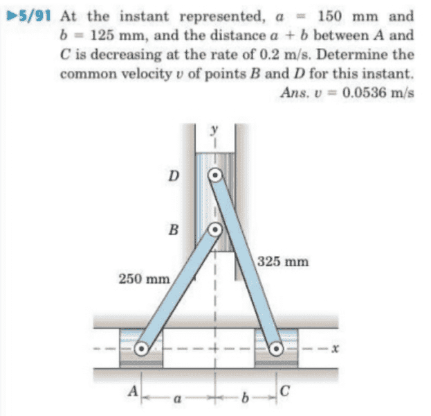

What is the solution for relative velocity of sliders?
In summary, the conversation was about finding the instant centre of rotations for AB and CD, with lengths of A -> ICab = 200mm and C -> ICcd = 300mm. The attempts at solving the problem involved using the equation Va = 0.2 + Vc and Vb = Vd, but there was a mistake in assuming Va and Vc to be positive in opposite directions. The correct answer is 0.0536m/s.
Jonski
42
[/B]
Va = Va/c + Vc
Va = 0.2 + Vc
Vb = Vd
I began by finding the instant centre of rotations of AB and CD. Both of these form a right angle triangle and the length of A -> ICab = 200mm and C -> ICcd = 300mm
Va/0.2 * 0.15 = Vb
Vc/0.3 * 0.125 = Vd
Va/0.2 * 0.15 = Vc/0.3 * 0.125
0.75*(0.2+Vc)=0.417(Vc)
Vc = -0.45
Vd = -0.1875m/s = Vb
The answer is 0.0536m/s, but I am not sure why taking the instant centre does not work. Did I mess anything up. Thanks in advance

I believe that your problem lies at the line indicated above. It appears to me that you've taken velocity Va to be positive to the right and Vc to be positive to the left. Then your Va + Vc = 0.2 and so Va = 0.2 - Vc.
Oh, thanks. I understand now
