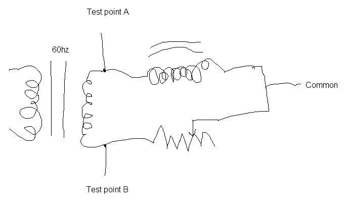

Yes, good idea. Here is my plan. I will set up a circuit with the coil and a variable resistor in series. I will drive the circuit with an ac source (at 60 hz) and measure the voltage at each leg on the source to the point where the resistor and coil join together. I'll adjust the resistor until the voltage is the same. I'll then measure the value of the resistor, which will equal the reactance of the coil at 60 hz. Easy! Thanx.

hmmm... I have tested several coils with this method and the results are textbook. I don't understand why I am not measuring the reactance.
https://www.physicsforums.com/attachment.php?attachmentid=46145&stc=1&d=1334214699
Sorry for the crappy schematic, but I don't know how to do it better. After I balance the (rms) voltage at the two test points, I remove the resistor from the circuit and note its value. It seems to work to get the reactance at 60 hz.

That will give you the reactance, but you need to be measuring the resistance, since you already know the reactance.
It is 5643 ohms.
