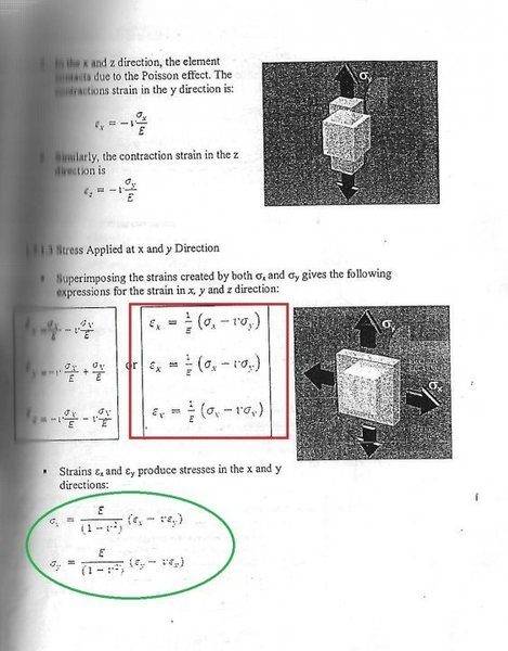

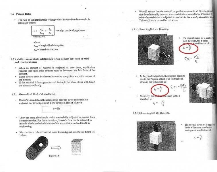

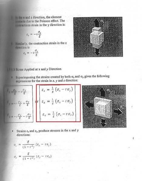

for the stress applied at x direction , the tensile strain εx should be = σx / E , right ?
and for the tensile strain εy should be = -vσx / E , am i right ?
I think so because in 1.7.1.3 , εy = σy / E - vσx / E ,
and εx = σx / E - vσy / E
Refer to the bottom part of picture , σx ,
after rearraging , i didnt get what the author get .. my working is :
Eεx = σx - vσy
σx = Eεx + vσy
= E(εx + (V / E)(Eεy )
= E(εx + vεy )
This is correct.
Eεx = σx - vσy
σx = Eεx + vσy
= E(εx + vεy )
You did the algebra wrong.

I'm going to let you figure that out. You have 2 linear algebraic equations in two unknowns, ##\sigma_x## and ##\sigma_y##. You should have learned how to solve such equations in first year algebra.
If you continue to have trouble with this, please submit the two equations and your working to the Precalculus Mathematics section of the Homework Forums.

chetzread said:
Are you sure ? Can you please look at it again ?
Yes, I'm sure that your answer is wrong, and I'm also sure that the book's answer is wrong? In the book answer, the terms in the numerators should have plus signs, not minus signs. Your answer should have a denominator which matches the book's denominator.

do you mean it should be σx = (Eεx + vσy ) / (1-(v^2)) ?
It's time for you to learn to use LaTex.$$\sigma_x=\frac{E(\epsilon_x+\nu \epsilon_y)}{(1-\nu^2)}$$

why there is $$\{(1-\nu^2)}$$ below it ?
chetzread said:
do you mean this ?
C'mon man. You need to learn algebra.
$$E\epsilon_x=\sigma_x-\nu \sigma_y\tag{1}$$
$$E\epsilon_y=\sigma_y-\nu \sigma_x\tag{2}$$
Multiply Eqn. 2 by ##\nu##: $$E\nu \epsilon_y=\nu \sigma_y-\nu^2 \sigma_x\tag{3}$$
Add Eqns. 1 and 3 to eliminate ##\sigma_y##:$$E(\epsilon_x+\nu \epsilon_2)=(1-\nu^2)\sigma_x\tag{4}$$
Solve Eqn. 4 for ##\sigma_x##

why my working is wrong ? I noticed that in your working , you used 2 equations which is $$E\epsilon_x$$ and $$E\epsilon_y$$

Like I said: Put your working in the Precalculus Mathematics Homework forum and let them help you figure out what you did wrong.
Of course you need to use two equations. There are two unknowns: ##\sigma_x## and ##\sigma_y##

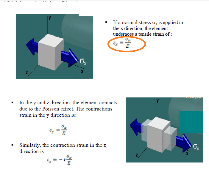

sorry , just to verify my concept again... is εy = σy / E ?
From another book, the εy is σx / E ..Which is correct ?
check a third book.
Chestermiller said:
check a third book.
It's really hard for me to get a third source . I already searched thru many websites , but i couldn't find this . I could only get simple explanation of poisson ratio, but not the the explanation about when the force is applied in a direction , find the strain in another direction .
Can you explain the concept ?
Chestermiller said:
check a third book.
here it is
