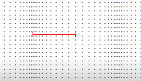

I thought about standing waves, but then what is the 3 m all about? The problem clearly states, "a single air molecule vibrates with a period of 0.025s, and across a width of 3m" which can only be interpreted that an air molecule vibrates with amplitude 1.5 m. If the nodes are 3 m apart, that is not the distance traveled by the vibrating air molecules (see video simulation below) but maybe the author of the problem thought that they do.

Please help me understand your guess about the author's model. We have a harmonic wave that we can write as $$y(x,t)=A~\sin\left[2\pi(\frac{x}{\lambda}-\frac{t}{T})\right]$$We are looking for the speed of propagation ##\frac{\lambda}{T}##. The period ##T## is given. How do we extract ##\lambda## and what is its relation to the given 3 m? If I take a snapshot of the traveling wave (below), the peak-to-trough distance is indicated in red. Clearly, any given molecule oscillates with amplitude ##A## that is a fraction of that. Also, I don't understand how the wavelength can be ##\pi\frac{\lambda}{2}.## I suppose I don't understand what the peak-to-trough distance ought to be according to the guessed at author's model.
