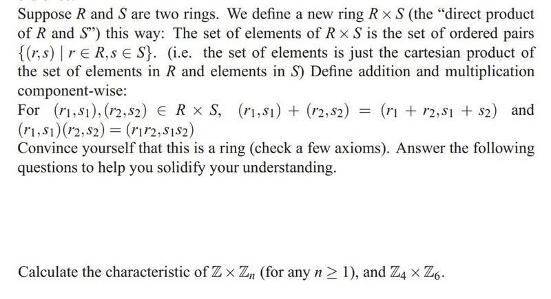

See attached image
For the first half of the question, ordered pairs would be (1, [1]), since 1 and [1] are the multiplicative identities in these rings. but no matter how many times we add (1, [1]) to itself, we'll never get (1, [1]) again. does this mean this ring has zero characteristic?
stripes said:
See attached image
Yes, it has zero characteristic. What about the other ring?
Other ring has characteristic 12, I hope.
Sure it is, it's the least common multiple of 4 and 6.
