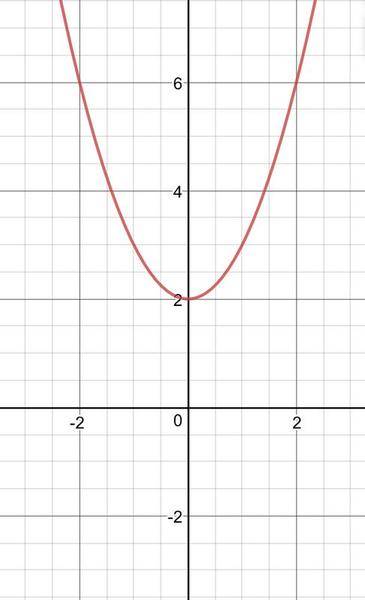

Mark44 said:
Yes, that looks better.
Is it correct ?
Fatima Hasan said:
Is it correct ?
No.
The equation ##\frac{y^2}{4} - \frac{x^2}{4} = 1## is NOT a parabola. The graph you showed appears to be the graph of ##y = x^2 + 2##, which is completely unrelated to your equation.

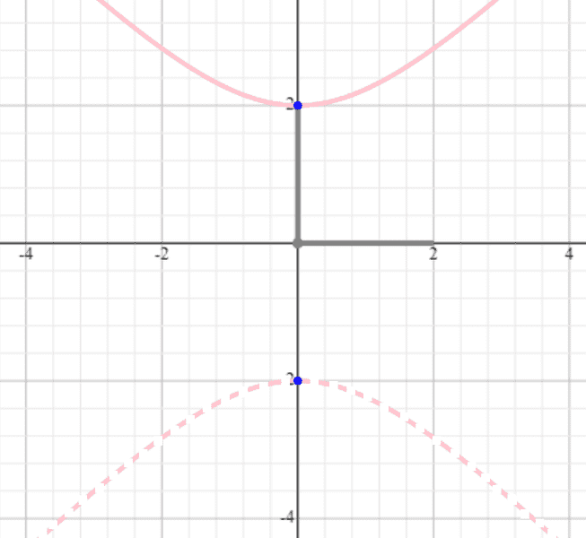

Mark44 said:
Bingo!
(Meaning, yes, that's it.)
