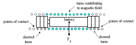

@gneill said it well in post #30. Use the amount of wire that the current would be flowing thru when in actual use. That is, the Blue colored turns in the photo gneill posted.
You do not have to cut the wire for this measurement, just make the connections for current measurement across the same wire length.
And Yes, it is a series circuit as in your photo of measuring current. The length of wire replaces the light bulb and resistor, and your small battery with magnets replaces that big 6V battery.

gneill said:
It seems to me that the only part of the coil that is energized by the battery lies between the magnets at either end of the battery. You might consider improving the efficiency by insulating all but the end magnets from the coil so that the inward magnets aren't shorting out the coil turns that they span. This might involve making the end magnets slightly larger in diameter (maybe wrap them with a conductive sleeve of some kind.
The length of wire you should consider for finding the resistance that the battery "sees" is the length of the coil comprising the turns that are contributing to the magnetic field. Measuring the resistance of such a short piece of copper wire is probably more trouble than it's worth. Look up the resistivity of gauge of wire you['re using and plug in the length of wire in that many turns of the coil.
Oh, so the amount of current measured would be in a circuit that had a copper wire as long as the number of coils in between the two magnets?

Expect around 3 to 8 Amps for a new battery. (that's just a guess :wink:)

Ok, say this distance is like 20-25 cm of copper wire. What would the current be? any estimate?
FPull= ( n x I )^ 2 * μ0(A/(2g)^2)
n would be the number of copper wire coils in between the two magnets
i would be measured using the distance of the coils in between the two magnets
A would be the cross sectional area of the magnets
And g would be the thickness of the magnets.
