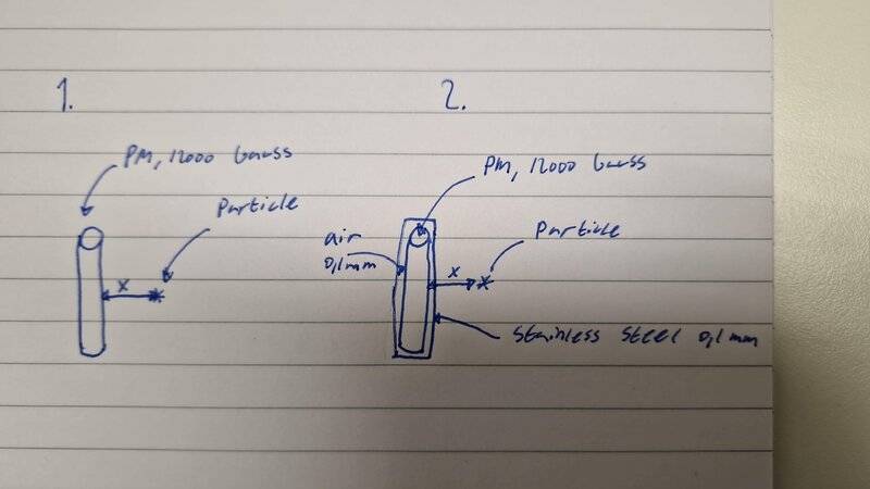

Is it possible to make rough calculations to calculate the force that a parmanent magnet exert on a small particle?
Dear readers,
I have a question regarding permanent magnets and the force they generate on particles, which is far from my comfort zone. I have the option on using two types of permanent magnets and with two different setups. Imagine that we want to attract small particles using the magnets. Assume that the same particle is placed on the same distance from both magnets, let's say 10 mm.
  1. A magnet with 12 000 Gauss with given dimensions put directly in the vicinity of the particles
  2. A magnet with 12 000 Gauss with given dimensions (the magnet is smaller in size compared to 1), but around the magnet there is a thin air pocket (lets say 0.1mm around the magnet) and then also a casing of stainless steel of 0.1mm.
Coming from the field of heat transfer I am used to work using the electrical analogy, where can get a heat transfer resistance by taking each material dimension and heat conductivity into account to find the total heat transfer rate. I understand that magnets generates a magnetic field, and when I have tried to search for this I have mostly found FEM tools.
I would like to get a rough estimate to compare, i.e. is the force 2 or 3 times higher? Any advice on how I can reason or what equations I can look into?

Dear Tom.G,
I am sorry for the confusion. Both magnets are permanent magnet with 12 000 Gauss. The SS are not magnetic. I have attached a sketch to make the problem more easy to understand.
Any advice regarding which equations I should look into or any example? I have never worked with magnets and these types of calculations before so I am quite lost :oops:

p.s. Your drawing shows a particle half way between the poles of a bar magnet. The net force at that position is approx. Zero, equal force toward both poles. You would get better results if the particle is on the magnetic axis of the magnet.
It's complicated and there won't be a good solution without spending a lot of time on a simulation - simply testing it will be much easier. It will depend on details of the magnet, and it will depend on the type of steel as well.
There should be a force towards the magnet if the magnet is too long (don't see the length given). It's likely to be stronger without the steel as that will act as flux return.

I would just love to have some estimates, otherwise I will ofcourse do a practical test to determine the distance.
Rod 1) is 42 mm high with a diameter of 9 mm.
Rod 2) is 30 mm high with a diameter of 7 mm.
Excatly, I noted that the steel seems to make the magnet much weaker, but the volume of the rods are also quite different so that is also a reason for my questions, how much is it due to the dimensions if the rod and due to the stainless steel (304).

The purpose is to see if we can attract, for instance, magnetite particles flowing in a water tube. The steel around the second rod is of type SAE-304.

They are, what I would want to do is to get them to stick to the rod. Let's say you have a tube system filled with a mixture of water and some ferrous particles, so I want to see if this "filter" would be able to help me collect the particles from the water stream.
If you wish to maximize the "pull" over a short distance then a configuration using both poles (like a" horseshoe magnet") is much stronger.
The magnetic properties of stainless steel are quite variable depending upon heat treatment and even mechanical working so be aware that this is likely to be a problem.

The reason for the "wand" shape is because we need to insert the rod into a tube, thus making the "hole" as little as possible. I am looking to filter the stream, like insert the rod for a couple of days and then take it out of the stream with the particles attatched to it.
So if the size is different but both have the same number of Gauss, can we draw some conclusions just from that?
Why do you need to "insert" anything? What is the tube ? Will the field penetrate through it?
The issue is not just the field strength. The gradient supplies the motive force to the particles, so everything about the shape matters. How much resource can you throw at this effort and how critical is the result? What is the venue here?
If both magnets have the same geometric shape, but the difference is just is size?
