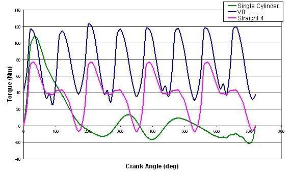

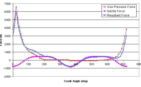

Good good, well you can use the following method.
You need to plot the gas pressure force vs crank angle. Then to find the inertia force of the piston going up and down, and plot that vs crank angle.
You can combine these two fo find the force acting down the cylinder axis. The graph should look like this:
You acn then use this figure to work out the torque, at the crankshaft using the folling equation.
From that you get a graph of torque vs crank angle. Fin the average torque and work out power from that.

Thats a judgement call, as with any other numerical simulation, the smaller the timestep the more accurate but time consuming it is.
Only you can judge the level of accuracy required. Tbh I can't remember what I used, but just that I got to within 5% accuracy. I didnt have a plot of gas pressure force I had to construct one and had to estimate pumping losses.
Note that at high engine speeds, the torque graph looks very funny, this is because inertia forces dominate and the gas pressure makes no difference. The average torque should always be the same though, if the gas pressures are constant (they arent in realisty, but i made that assumption)

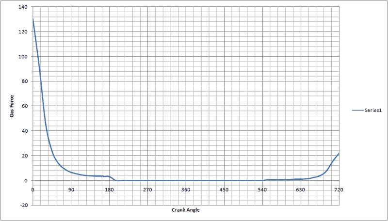

how did you determine the gas forces..mine looks a bit differ..can give me the formula...already pm you..please help me chris X(
What are you trying to achieve, and what have you done already?
EDIT: It may be worth just starting a new thread on this.
here is my F vs theta...
You're gas forces look like they are taken directly from an ideal cycle PV diagram.
I did some tests and applied some assumptions to my ideal cycle PV to get a more representative graph.
im tryin to get ideal force vs theta..from my pv diagram..thus i multiply the gas pressure with area...however my PV diagram start from BDC at 180dgree..ive shifted the angle to get a graph like yours..however i just ended up like that...considering at intake and exhaust the pressure is equal to atm
did you mean that I've already found the answer? sorry i have limitation of references...now only you can guide me haha
Well whether you have found the answer depends on the reason for creating the graph.
If the idea is to just convert an ideal Otto PV diagram into force vs crank angle then your graph is exactly what I would expect to see.

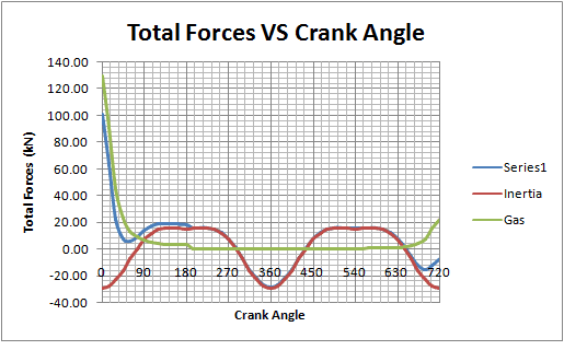

hey chris tenx 4 your previous help :biggrin: i manage to get the ideal result..i've also done several graphical result for part load and volumetric efficiency...here is my result...is there any assumption that i can make so that my result will slightly comes like yours? I've thinking about making ignition at 20 btdc sadly i get stuck on the mathematical modeling...do you still have the spreadsheet? can you please send an email to me?

I don't have the spreadsheets to hand any more, I made my assumptions to the PV diagram so they were there before I translated it to force vs crank angle.
I didn't model that bit I just put in the values manually, it was a bit of a fudge because I didn't have a running engine to test against. So I picked a peak pressure value of 75% theoretical maximum, as found from an old book. At set to peak to 13 deg aTDC, which is where the engine was tuned to give peak pressure.
Ended up giving a power value just over 5% over real value.
